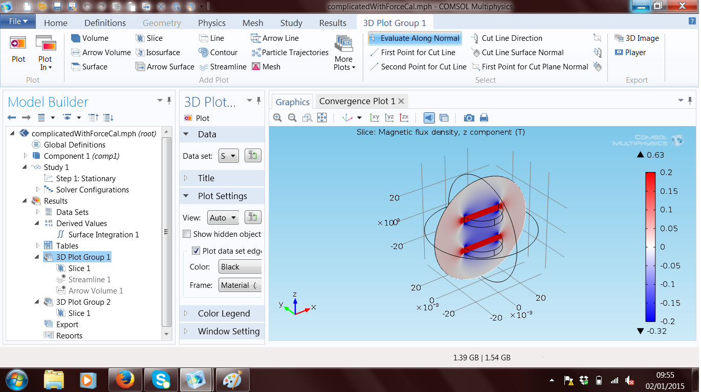

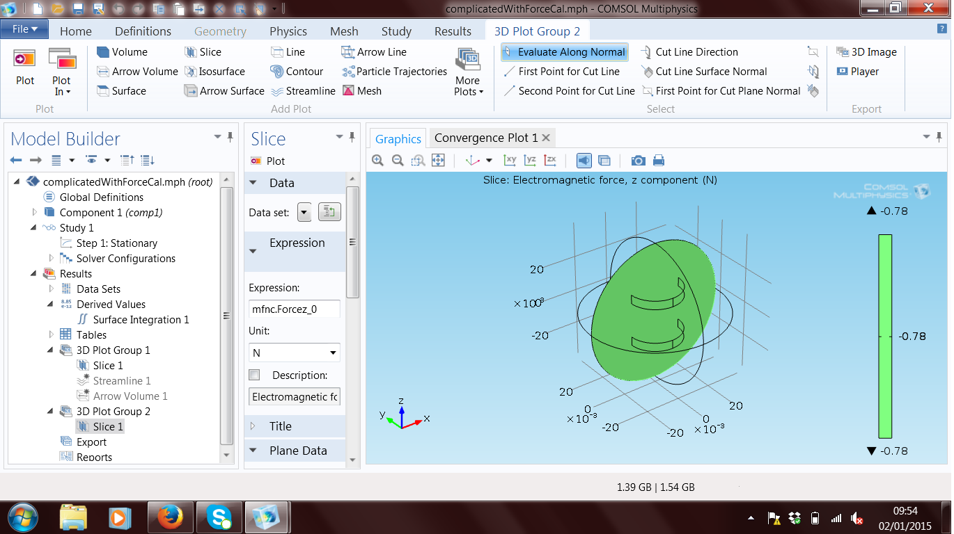

In response to your instruction, I investigated incrementing the sphere radius and set mesh refinement to "Extremely Fine". My results were:
SphereRadius(m) ForceCalulated(N)
0.04 -0.78
0.05 3.48
0.06 1.24
0.07 -0.86
0.08 0.63
0.09 -2.07
0.10 -2.56
0.11 -0.083
0.14 0.54
0.2 -3.22
I cannot see any clear trend here, and from the magnetic flux density plot, I think that increasing the sphere radius further will not reduce edge effects significantly. which suggests that I have made an error in setting up the force calculation (Model Builder > comp1 > mfnc > Force Calculation 1). Have I set up this calculation correctly? I am also unsure if I have set up boundary conditions appropriately.

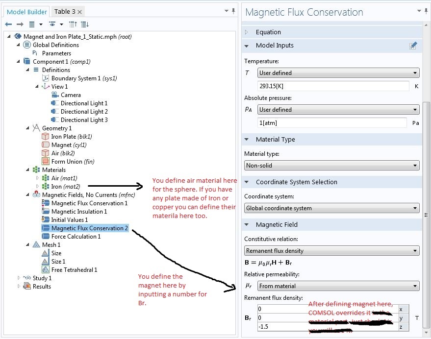

I checked your model. If you only need to calculate magnetic force between the two separated cylinder magnets in your problem:
You should not define magnets by Material, as the magnets can be assumed to have linear behavior. So, you need to define them in Magnetic Flux Conservation node. But, using this node you assigned magnetization to the air sphere, why ???? This is the reason that when you increase the air sphere radius your force changes. Following some solved examples in COMSOL about permanent magnet, you can solve this problem easily.

If you follow the second example you mentioned, you can model the magnets easily. Just follow the steps. Attached may help you to figure out your problem.
