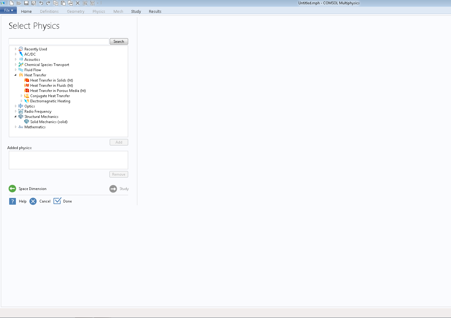

My university has comsol multiphysics 4.4, I want to do thermal analyse of friction between moving parts in my model, which I am not able to do because I am not able to see the multibody dynamics option under structural mechanics.
Why is that, is multibody available in some upgraded versions only.
Is there some other method to do it.
P.S.- I have attached a screen shot of what I am getting.

Hello ta,
You cannot determine what modules your license includes by looking at the "Select Physics" window (of which you sent a screenshot). Rather, you need to go under File>Licensed and Used Products.
Hello ta, You cannot determine what modules your license includes by looking at the "Select Physics" window (of which you sent a screenshot). Rather, you need to go under File>Licensed and Used Products. Best regards, Jeff
