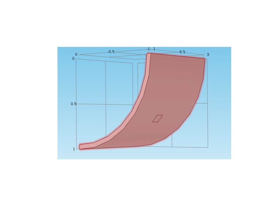

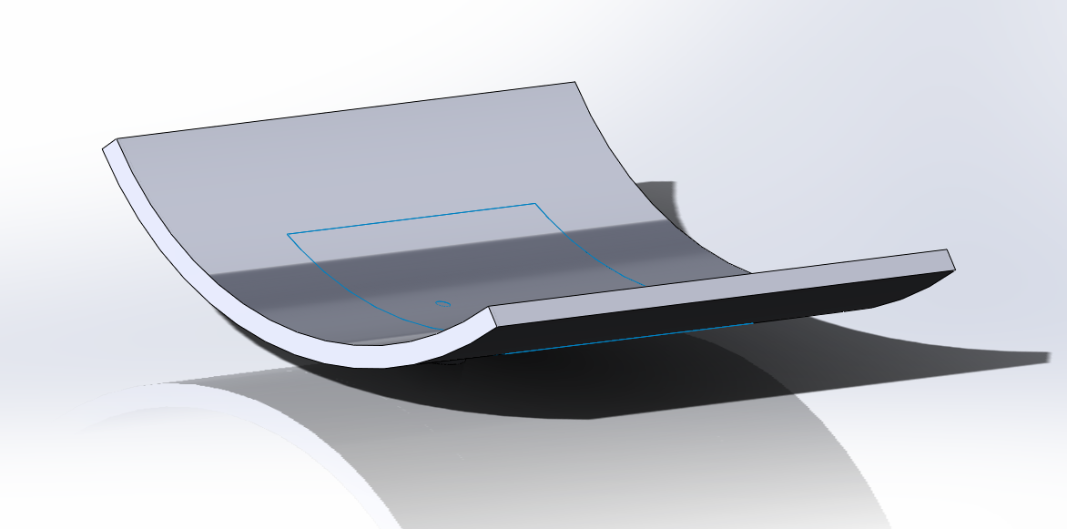

Concave Workplane / Concave Geometry
Do you know if there is a way in order to draw attached geometries in COMSOL?
Or any idea if I am able to create a concave workplane?
Thanks in advance.

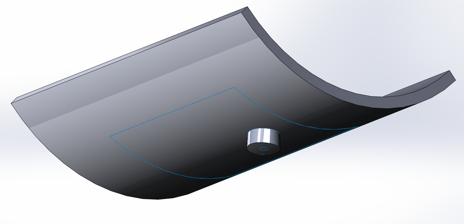

Thank you very much for your help. Actually I have already tried what you mentioned however I have stuck when I was trying to draw mounted concentric cylinders which are mounted on the concave surface. Do you have any idea if I can draw those cylinders too?
[QUOTE] This is not very elegant, but will this do? If you don't have version 5.0, this is the procedure: 1. Create a hollow cylinder and cut it with, e.g. blocks to a desired shape. 2. Draw another block across this tubular wall. 3. Partition the last block. 4. Convert this partition to curves. 5. Remove extra edges. br Lasse [/QUOTE] Thank you very much for your help. Actually I have already tried what you mentioned however I have stuck when I was trying to draw mounted concentric cylinders which are mounted on the concave surface. Do you have any idea if I can draw those cylinders too?

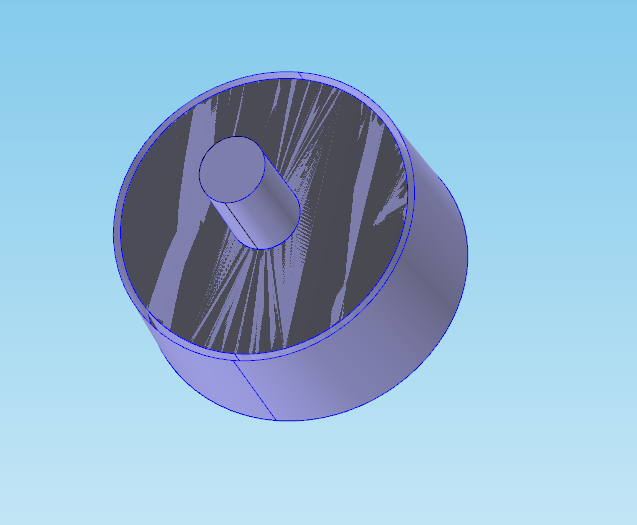

Posted: 1 decade ago 11 févr. 2015, 17:10 UTC+1
As an alternative to Lasse's approach:
Since it looks like you have a CAD software, you could import the geometry using the COMSOL CAD Import Module, rather than redrawing the geometry using COMSOL's own drawing tools. The CAD Import Module supports a wide range of formats, including Parasolid, step, sat, IGS, as well as the native formats of a number of common CAD programs (See www.comsol.com/products/specifications/cad/ for more details).
Thank you very much for your advise. I have already tried to Import my CAD file as well. However I have got some geometry issues. So my simulation didn't work properly. I think the attachment explains my problem much better.
Do you have any suggestion for this problem?
Thank you.
Osman
[QUOTE] As an alternative to Lasse's approach: Since it looks like you have a CAD software, you could import the geometry using the COMSOL CAD Import Module, rather than redrawing the geometry using COMSOL's own drawing tools. The CAD Import Module supports a wide range of formats, including Parasolid, step, sat, IGS, as well as the native formats of a number of common CAD programs (See http://www.comsol.com/products/specifications/cad/ for more details). Best, Jeff [/QUOTE] Thank you very much for your advise. I have already tried to Import my CAD file as well. However I have got some geometry issues. So my simulation didn't work properly. I think the attachment explains my problem much better. Do you have any suggestion for this problem? Thank you. Osman
