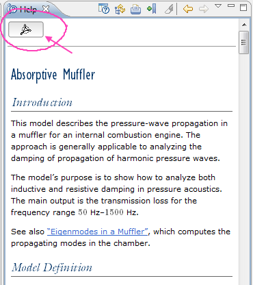

Hi Naveed,
- All models are documented in the help system and as individual PDFs. You can find the PDFs the following way: Click the Dynamic Help button. Select File->Open model library. In the Model Library windows, select the model you are interested. Now find the Related Topic in the dynamic help window. Click the Model name. You now get a PDF button (see attached screenshot pdf.png). This will be much easier in version 4.0a, where you will be able to click the button directly in the model library window.
- Equation (PDE) display is planned for a later release (4.1). As you already noticed the equations are available in Equation View but are generally written in weak form. In 4.0 you can find the continuous PDE formulations in the Mathematics interfaces. (See attached screenshot pde.png)
Niklas Rom, COMSOL

Hi Naveed,
Niklas Rom, COMSOL
