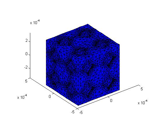

But when i include more than one cell in the computation. Let's say i would calculate on a cube of 2x2x2 cells using some operators like mirror or move to split the original cell g3. It doesn't work even the Meshextend processing is done. An error message appears

(the attached image below is the meshing process where my codes end)
