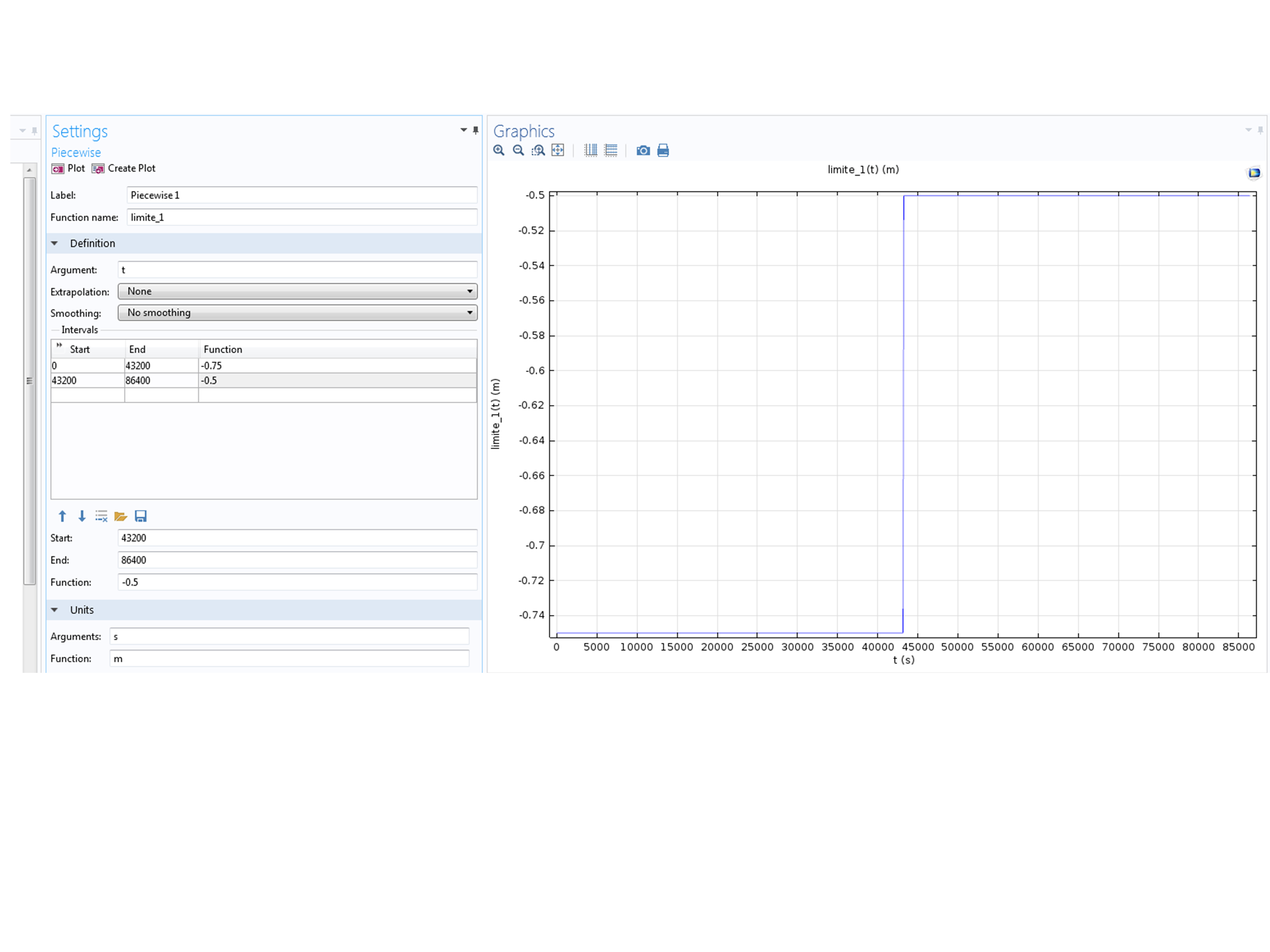

                                                Posted:
                                1 decade ago
                                25 févr. 2015, 09:08 UTC−5
                                                    Have you defined the units of the argument (t in your case) and the function? See attachment. Function is piecewise.
br
Lasse
br
Lasse
