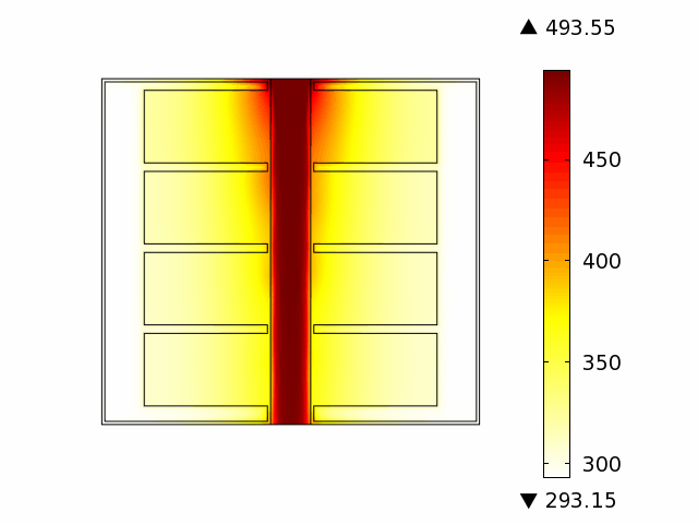

Posted: 1 decade ago 8 nov. 2011, 12:56 UTC+1
Hi Anhmet,
I have just seen the problem you had time ago,and i would like to know if you can help me.
Im working in something similar,a heated fluid inside a pipe.Joined to this pipe there are fins that transfer the heat to a phase change material.
i achieved to make the fluid flow but my problem is relationated with his temperature.I want the fluid to enter at 573K and transfer the heat to the rest,so the temperature at the beginning should not be the same that the one at the end due to the heat losses.Instead of that i have a fluid flow at constant temperature of 573K and i dont want that.
Did you achieve to do that in your model???Can you give any advice or suggestion,i would be really grateful!!!!
Carlos

Posted: 1 decade ago 8 nov. 2011, 16:15 UTC+1
Hi Carlos
Try to set your "initial value 2" temp at 300[K] for the fluid, and keep the inlet boundary at your high temperature, then change your time stepping "range(0,50,1000)" to "0,1 2 5 10 20 range(50,50,1000)"
You will then see the temperature of the fluid change over the first 3-4 seconds, thereafter, with your flow, the fluid temperature will be almost constant. Check the BIOT value for the different parts of your model

Posted: 1 decade ago 8 nov. 2011, 16:39 UTC+1
Hi Ivar,
But that temperature change corresponds to the initial change temperature of the fluid(from 300K(initial value) to 573 K(temperature boundary condition)),isnt it?It should be like this at the beginning,may be,but after that,the temperature reached by the fluid should be less.,because its being heated by a "colder fluid"(not at 573K)
I mean,we can see how the initial fluid is heated until reach the maximum temperature but then,nothing happens,it remains at that temperature and it shouldnt be like this,isnt it?
Did i understand you???
Thank you for your time and for being helping me!!!
Carlos
ANOTHER THING:
I HAVE ALSO BEING SUGGESTED ABOUT USE "STEP FUNCTION"...WHAT DO YOU THINK???

Posted: 1 decade ago 8 nov. 2011, 22:11 UTC+1
I believe you are getting fooled by the colors, you should chek the numerical values by integrating over the input and output, or make a temperature plot over the input/output boundaries
For the step function its often a good way to get a flow started, by ramping it gently with a continuous smooth function. But in your case, with a bundary mesh and a laminar inflow, I got the solver to converge quicly even without a step function, because you have a low flow rate

Posted: 1 decade ago 8 nov. 2011, 22:39 UTC+1
Hi Ivar,
Do you think the temperature plot is wronga nd the temperatures already changes?How can i do temperature plot over the imput/output boundaries as you said to check it?Im desperate with this!
Tomorrow i will also try the step function,both for the tempearure and for the velocity.
With this function,the velocity and the temperature will vary from 0 to the desirable value in a period of time,and then they will change but not due to this function(the fluid will dicrease the temperature due to heat losses) ¿?
Im not sure what i will achieve with this function!
Thanks you Ivar,you are helping me a lot!!

Posted: 1 decade ago 9 nov. 2011, 09:43 UTC+1
from my experience there are very few "bugs" in COMSOL, but its easy to give wrong or incorrect input in multiphysics simulations. Your temperature plots are correct, but the automatic scale and graphical rendering can give you wrong impression on surface plots.
You can add a line plot and select a line along the inlet, then choose to plot the temperature the inflow velocity and the product of the density rho, heat capacity Cp times the temperature T times the velocity and you get the power influx W/m^2. The same for the outlet, and you can compare easier on 1D plots. To combine the two plots, you need to project the results from the inlet onto the outlet. Or you define global variables

Posted: 1 decade ago 9 nov. 2011, 13:33 UTC+1
If i put the temperature in "intial value 2" at 493K,and the inlet temperature also at 493K,the temperature in the fins at the end of the simulation is different at the top than the tempearure fins at the bottom....so the fluid is loosing heat and is transferring less heat¿?but the tempearure fluid seems to be the same in all the pipe
I dont know what to think,you think is correct,but how can i do Comsol plot it right??
I attached the file

Posted: 1 decade ago 9 nov. 2011, 18:40 UTC+1
I've run your simulation. It looks fine. See attached files. Animation shows how heat penetrates from water to aluminium and SS. Plot of average outflow temperature vs time shows that water loses heat.

Posted: 1 decade ago 9 nov. 2011, 19:01 UTC+1
Hi Andrzej,
That you for looking my model.
I dont understand.Looking at the plot Av-Out vs T,i see that the temperature of the fluid increases until 493K,so its not loosing heat,and in the other plot the entire pipe its at the same color.The fluid temperature at the end should be inferior than 493K,isnt it?
Could you explain me?
Thanks,
Carlos
AND HOW DID YOU DO THE OUTvsT PLOT??Thanks

Posted: 1 decade ago 9 nov. 2011, 22:14 UTC+1
In the limit, when time tends to infinity, the temperature tends to 493K (inflow temp.) in all domains and the rate of heat transfer goes to 0. Under these conditions (steady state) the outflow temp. is equal to the inflow temp.
How to get the plot of average outflow temp. vs time?
Under the Results node right-click Derived Values. Choose Average > Line Average. Line Average window appears. Under Selection choose boundary 28. Click = icon (evaluate icon). In the Results window (right-bottom corner) click Plot icon.

Posted: 1 decade ago 9 nov. 2011, 23:01 UTC+1
Hi Andrzej,
Thank you very much for your answer,again!
Why do the domains tend to 493K if the intial value is 493K??They have a flow entering at 493K also,so at the beginning,the outflow temperature should be the same that the inlet temperature,but after the time simulation,it shouldnt be like that,the entering flow should have dicrease his temperature due to it has transferred heat to the rest.......SORRY for my clumsiness!!!!!I just want to simulate the heat transferred by a fluid that enters at that temperature...do you think is already achieved?
Why is not that reflected in the temperature plot???The fluid should have different colors(less temperature)at the end!!!
Sorry again,i hope to understand what you mean
Thank you for your time,really!!!
Carlos
CAN I DO A PLOT "OUTFLOW TEMPERATURE vs TIME" or it doesnt have sense?

Posted: 1 decade ago 10 nov. 2011, 07:27 UTC+1
Hi Carlos
take a look, you have a flow of 0.5 m/s your device is only 0.45m long, then you look at the temperature after 50 seconds, the fluid has passed 100x the length of your device, that is why the fluid appear at more or less constant temperature. Try a stepping time much shorterr at the beginning like 0.1 0.5 1 2 seconds and you will see better effects. By the way have you checked your mesh size, time stepping, heat diffucivity and heat capaciyt time constants, and their coherence across your model ?. Chekc a book on the Biot number and the time constants for yout thermal analysis, as well as the fluid Renolds, Prandtl and Nusselt number, all these are also useful to check the validity of your model settings

Posted: 1 decade ago 10 nov. 2011, 17:09 UTC+1
Initial temperature of Al+SS domains is 293K as you can see in Prueba Conjugate HT.mph.
Hot water of the constant temperature 493K flows into your system. All outer boundaries (exept inlet and outlet) are insulated. Therefore, the final temperature of all domains (H2O+Al+SS) must be 493K irrespective of the initial temperature.
Outflow temperature Tout is a function of the two variables: t (time) and x-coordinate. You can plot Tout vs t fixing x or
Tout vs x fixing t.

Posted: 1 decade ago 10 nov. 2011, 18:39 UTC+1
Hi Andrzej,
Today i made a 3D simulation with a fluid putting the same boundary condition(TEMPERATURE and INLET).The fluid looses temperature,so i think the design should be ok,as you said!
I will try to make the plots,i will tell you if i can!

Posted: 1 decade ago 10 nov. 2011, 18:45 UTC+1
Hi Ivar,
You were also right,the water looses temperature,i have seen it in a 3D simulation with the same boundary condition,but not in 2D.
Where can i check all these parameters??
Thank you very much for your time and help!!!
Carlos
