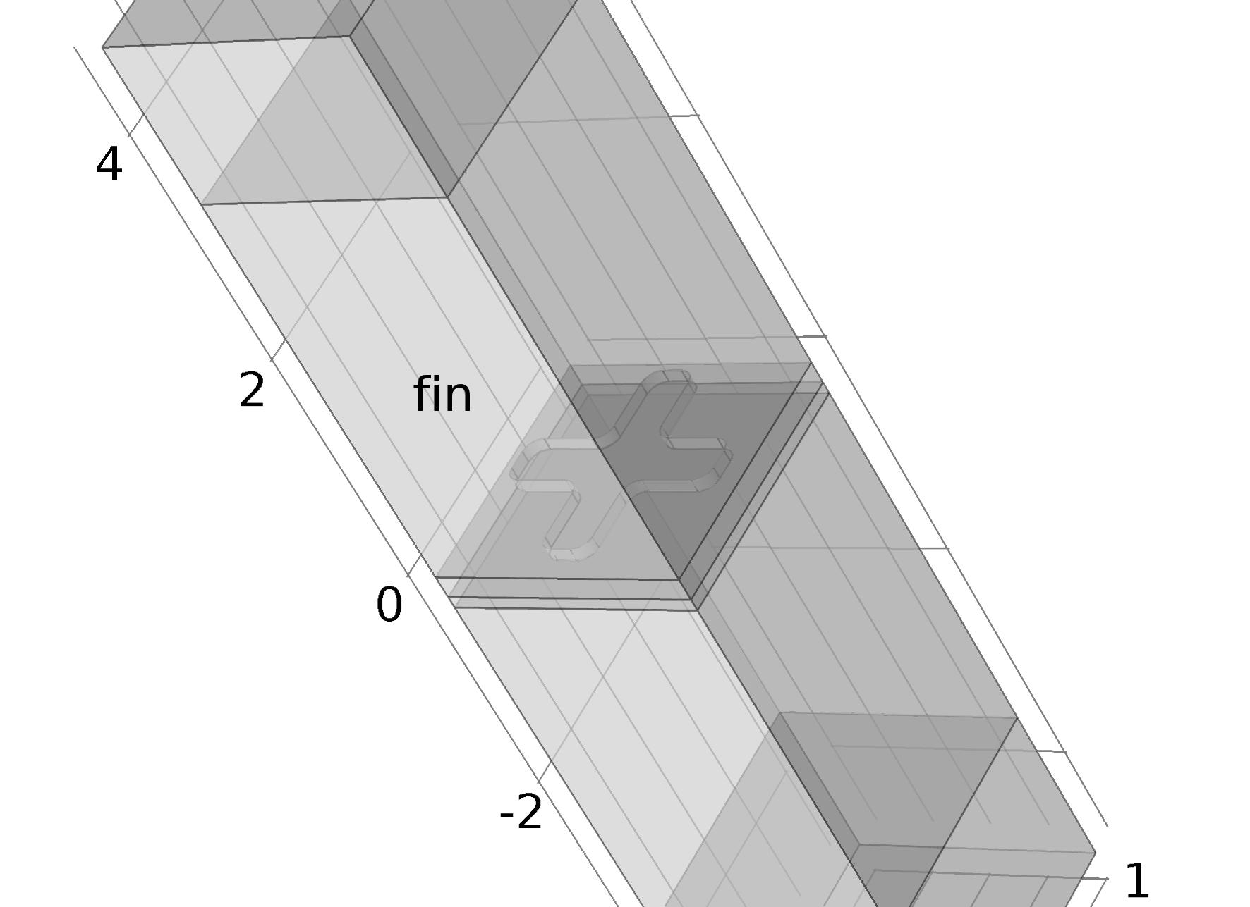

It seems that the RF module is most suitable for structures in the same order of magnitude as the wavelength.
Still the results I have , ar not as expected. The COMSOL examples are not really covering my structure (see fig)
I just need to tune the crossdipoles for optimal taransmission at 75 THz.
Probably my definitions of the E-field ( or should I use the H-field ??) are not correct
I have used emw and a wave excitation port : E= 0 (x,z) Ey = exp(-i*k_x*x)*exp(-i*k_y*y) [V/m]
Below the crossdipole is a port without power : E= 0 (x,z) Ey = exp(-i*k_x*x)*exp(-i*k_y*y) [V/m]
and i am plotting Reflection and Transmission emw.S11 and emw.S12.
Wavelength is in the mid-infrared ( 75 THz). Anyone experience with these type of simulations
I'm quite stuck so any help is very welcome
