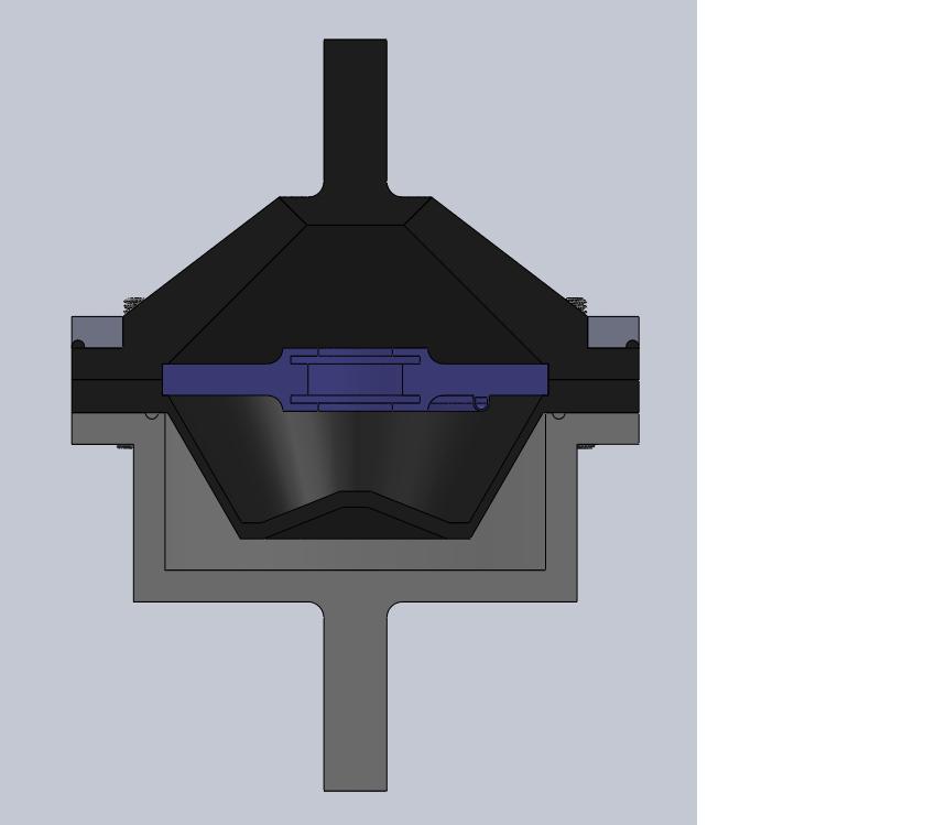

I am a newer user of COMSOL. I am trying to model a hydraulic engine mount using the Fluid-Structure-Interaction module. I followed the 'Obstacle in Fluid' tutorial, this is very similar to modeling the engine mount except I do NOT have and inlet nor an outlet. It seems as though it is having problems calculating the reaction force in the fluid, the model gives this error:

I cannot interpreat your error messages, I do not know enough about COMSOL internals, but I was woundering, if you do not have any inlet nor outlet, and a incomresssble fluid in a given volume, arent you overconstraining your model ?
The fluid is contained by two rubber volumes and separated by a metal middle piece and I am trying to examine the damping and stiffness of the mount. Attached is a pic of a (quickly drawn) typical hydraulic mount. The black is rubber and the silver and purple are metal. The upper and lower chambers are filled with incompressible fluid. I am trying to examine how the rubber deforms partnered with the reaction forces back from the fluid. Thank you for your help, does this still seem over-constrained or do you have any additional ideas?
