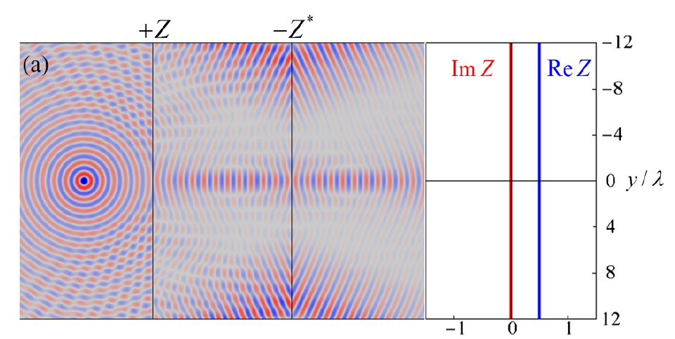

Thanks for your reply. Its an RF problem. I have attached an image below how I want it to be.

I've attached an example.

Posted: 9 years ago 12 févr. 2016, 05:36 UTC−5
Hi Dear sir its very useful file. But once i simulated then its field is inverted as compared to yours plot. Then i needed to put -1A to get same like plot of yours, whereas you put 1A. Where am i making mistake?

Posted: 9 years ago 15 févr. 2016, 04:05 UTC−5
Hi Sir I found correction. You used study at 180 degree and by default its at 0 degree. Whats reason behind out of phase plotting the data?

Posted: 9 years ago 15 févr. 2016, 17:43 UTC−5
I plotted it that way because the resulting plot was prettier. The plot is just a snapshot at a particular phase. Feel free to pick and plot any other phase snapshot of the solution that you prefer.
