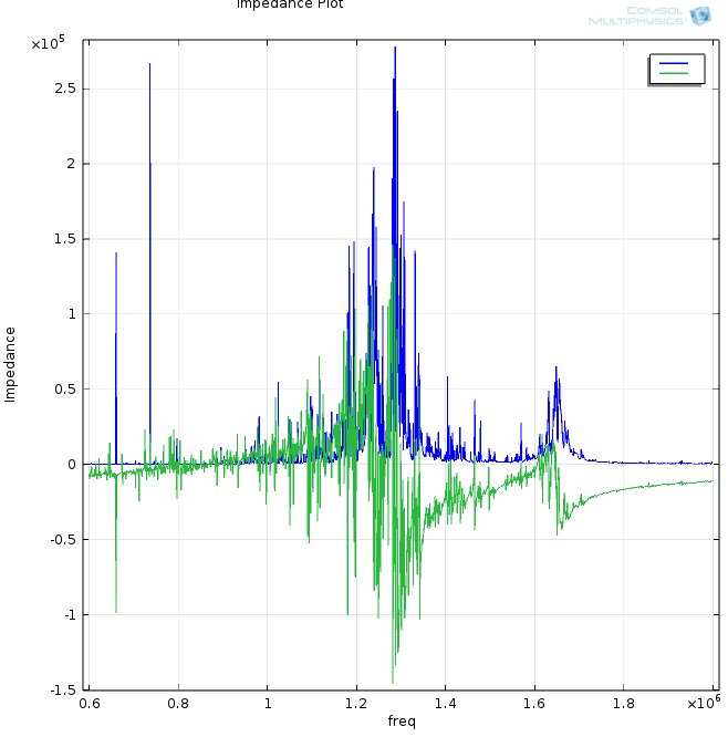

Hi Edgar,
I am able to get the impedance plot now, but if I put the PZT in air, I can get a clean and nice plot, but if I put PZT in water the impedance plots, both real and imaginary are very noisy. Do you have any ideas why this is happening?
I created a small PZT and put it into a larger block with water. Defined the top surface as terminal with voltage of 1V and bottom surface as ground. Gave the damping loss as 1/Qm=0.013 and dielectric loss of 0.02. ran the simulation and added a 1D plot group, then plotted the real impedance by expression as real(1/acpz.Y11) and the imaginary part as imag(1/acpz.Y11).
Do you see any problem with my method?
Thank you very much for your help.
Miao
