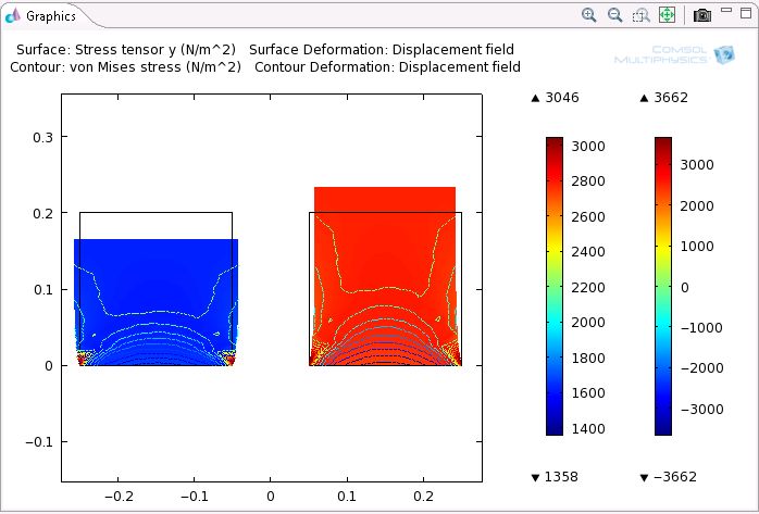

Posted: 2 decades ago 20 juin 2010, 13:28 UTC−4
what if you try something like this (its V4, check that it's the same in V3.5)
Hi what if you try something like this (its V4, check that it's the same in V3.5) Ivar
Posted: 2 decades ago 20 juin 2010, 13:31 UTC−4
And here are the view (only that in V4 it's not easy to identify which legend corresponds to which graph, but as the countour is Von Mises and von Mises >0 you should be able to identify it still unambiguously)
Have fun Comsoling
Hi And here are the view (only that in V4 it's not easy to identify which legend corresponds to which graph, but as the countour is Von Mises and von Mises >0 you should be able to identify it still unambiguously) Have fun Comsoling Ivar
