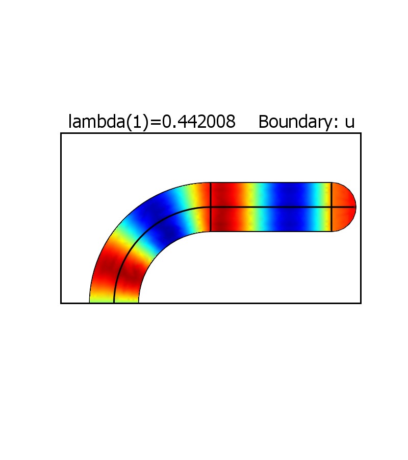

I have some problems with my 3D-mesh of my geometry (just a folded tube).

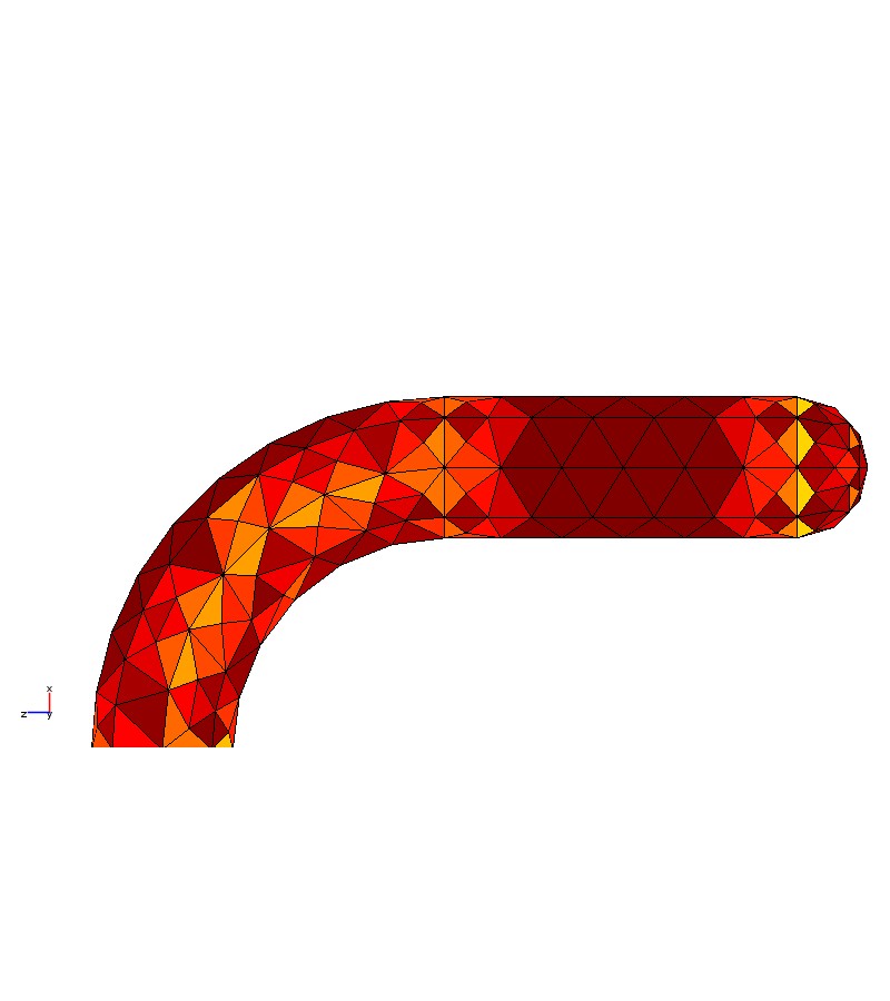

I used 1600 tetrahedrons using the mesh automatic procedure of COMSOL and using a "normal" size.
The quality of the mesh is good (quality = 1) at the leg of my tube but bad at the body (quality = 0.4) (see the attachement)...

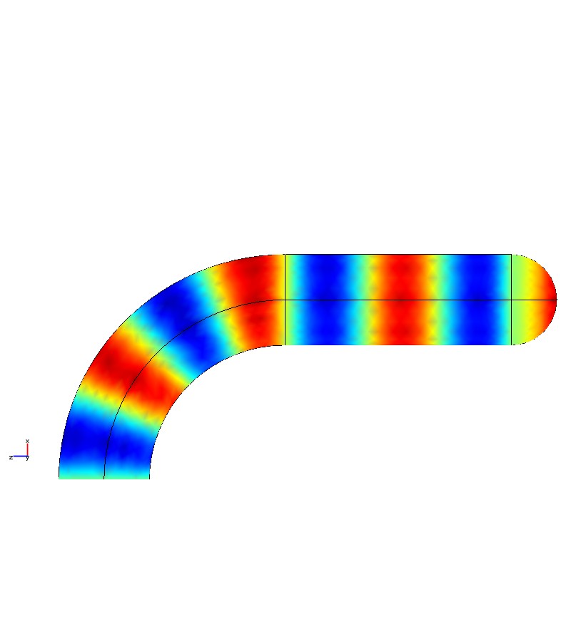

Due to this mesh (I think), the solution of my equations (the solution is the tension constraint on the surface of the tube) show some defaults...I mean some "triangular shapes" are visible looking at the solution (see the attachement)...I think that this default is due to my mesh (probably a little bad).
You will find in attachement two picturew showing the tube with mesh and the tube with the solution plotted (tension constraint at the surface of the tube). The defaults are visible looking at the solution (some "triangular shapes" unknown are visible on the tube in the solution)...
I do not know how I can remove these defaults...I tried to use a fine and a finer mesh but the problem is always there...Also, I tried to change the shape of the mesh but nothing is better...
Have you already see this problem in your model ? Have you a solution to solve it ?
Thank you very much for your help !
Best
Pierre
