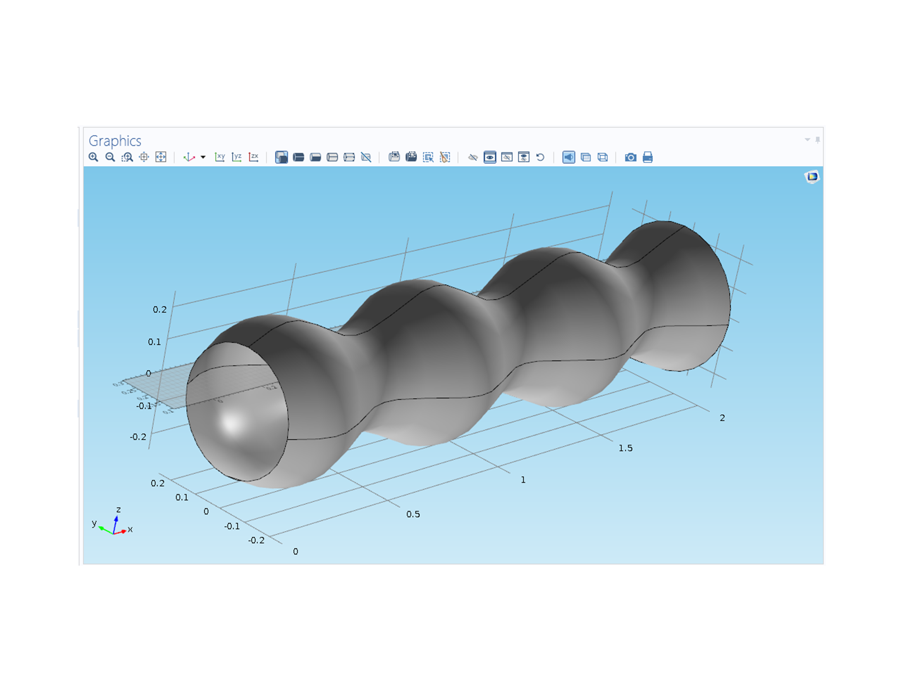

So how do you draw a periodic waveguide that has a simple mathematical expression in 3D?
For example, in this blog of corrugated waveguide
www.comsol.com/blogs/computing-impedance-corrugated-waveguide/
I was looking for some "nonlinear extrusion", but didn't see it.
It would be so nice of you if you could give me a quick answer even with one keyword.

How about a parametric curve in axisymmetric 2D geometry? Or by rotating a workplane? See my suggestion attached.
br
Lasse
How about a parametric curve in axisymmetric 2D geometry? Or by rotating a workplane? See my suggestion attached. br Lasse

Wow, such a nice work! This is exactly what I'm looking for. I would try it and post my feedback here in case other "rookies" want to have a look.
