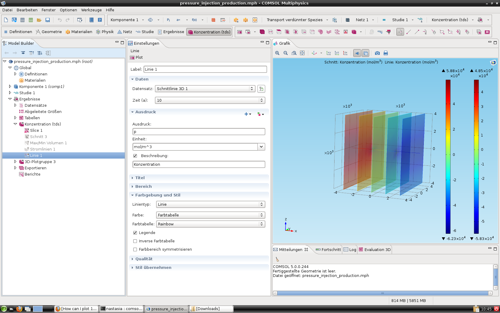

you can find under "results" > "dataset" > "cut line 1D" the defined cut line which dataset is choosen to "3D cut line". After I added this line under "results" > "concentration" (line 1), the cut line is shown but the profile along this cut line ( concentration along one axis) is not demonstrated. How can I draw the concentration course along this cut line?
Thanks and cheers
Nastasja K.
Hi, you can find under "results" > "dataset" > "cut line 1D" the defined cut line which dataset is choosen to "3D cut line". After I added this line under "results" > "concentration" (line 1), the cut line is shown but the profile along this cut line ( concentration along one axis) is not demonstrated. How can I draw the concentration course along this cut line? Thanks and cheers Nastasja K.
Posted: 1 decade ago 22 avr. 2015, 16:02 UTC+2
The concentration seems to be plotted correctly. It seems to vary between -6e4 and +6e4 along the line. I'm using Multiphysics 5.1, but I don't think that matters. What behavior do you see?
Posted: 1 decade ago 23 avr. 2015, 10:50 UTC+2
Yes, I also see a line which varies from -6e4 and +6e4. I want to plot a course or a trend in a 2D-coordinate system along the line. Is it possible to draw it?
Attached you can find a screenshot what I see.
Yes, I also see a line which varies from -6e4 and +6e4. I want to plot a course or a trend in a 2D-coordinate system along the line. Is it possible to draw it? Attached you can find a screenshot what I see.
