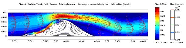

I was trying to simulate a FSI problem by modifying the COMSOL FSI example, trying to see the same effect presented in the following reference:
Zhiyong Li, Simulation of the Interaction between Blood Flow and Atherosclerotic Plaque, Proceedings of the 29th Annual International Conference of the IEEE EMBS Cité Internationale, Lyon, France, August 23-26, 2007.
It creates a plaque with cap and core of different Young's moduli, and computes the interaction of them with the blood flow. The model is shown in the attached picture.
In my modified model, when the simulation starts it reports
Failed to find consistent initial values.
Last time step is not converged.
Any trick to define the boundary conditions? I've tried composite and assembly geometries with no vail.
Thanks.

I assume his problem was the inlet boundary condition for flow. So, instead of entering Umax, you should enter Umax*flc1hs(t-.1,.1), in old comsol notation, or use a step function in Comsol 4.
