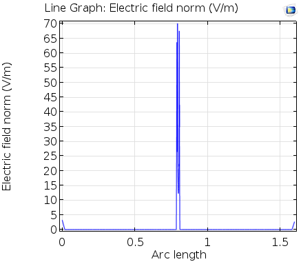

Hello, I am facing problems to analyze in time domain.
1. The E(x) plot that I have obtained is in frequency domain(attached file), which means at a one single frequency E(x) is a phasor or sinusoidal signal at every specific point along x with different amplitudes.
2. However, I want to see E(x) in time domain, which means it will show me how E(x) changing with x at a specific time t=0s, 5s, 10s and so on. This is essentially a 1D plot of E(x) Vs x at different time. I hope, I made my question clear to you.
Would you please suggest me how can I simulate this time domain analysis ? Is there any useful approach ? Please kindly, let me know. I am enlisting your expertise.
Thanks,
Rishad
