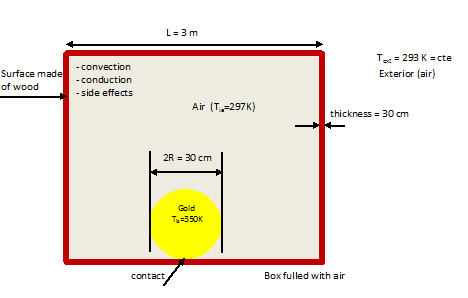

Let us suppose that a sphere (radius R) made of gold is located on a infinite surface made of wood. The system is enclosed in a box (length L) filled with air with a finite size. The sphere is very smaller than the dimensions of the box (L = 20 R).
The initial temperature of the sphere (Tis) is known, the initial temperature of the air in the box is known (Tib < Tis) and also all the relevant parameters of the system (calorific capacities, heat transfer coefficients...).
I would like to calculate the temparture of the sphere as a function of the time Ts(t) by taken into account :
- the thermal transfer between the sphere and the air (convection...)
- the thermal transfer between the sphere and the surface of the box on which is posed the sphere (convection, conduction...). The influence of this surface on which is posed the sphere is not negligible !
- the side effects due to the finte size of the box.
Up to now, I solved the the problem only when the box is supposed infinite with a sphere that floats in air (cooling of a sphere embedded in air) but how to set COMSOL to solve the problem above ? In particular to take into account the surface on which the sphere is posed ?
Thank you for your help.

To be clearer, my sphere is enclosed in the box fulled with air. The sides of this box are made of wood and the system {sphere + box} is embedded in air (infinite medium). According to experiments, the finite size of the box is to be taken into account in the calculations of the cooling of the sphere and all of the physical phenomena relating to the cooling of a hot body (convection, conduction...).
The box represents a wooden house...The design can be seen in attached file.
Than you for your help.
KB

You need the overall heat transfer coefficient of the wood wall, k_tot:
1/k_tot = 2/k_(a/w) + h/l_w
where k_(a/w) is the heat transfer coefficient between air and wood (I do not know where to find it), l_w is the heat conducivity of wood and h = 30 cm (thickness).
Next, what is the contact area between the gold sphere and wood? Can be a point.
Provided that these constants are known, the problem is solved. Use the Newton's cooling law for the heat flux between interior and exterior air (the latter is constant): Q = k_tot*(T_out - T_in).
At the contact of gold and wood yet another heat transfer coefficient is needed. If no BC is given here, the temperature profile is continuous, T_gold = T_wood.
The contact gold-air in the box can be treated in various ways, perhaps a thin barrier could be the simplest solution.
I wish this was helpful.
br
Lasse
