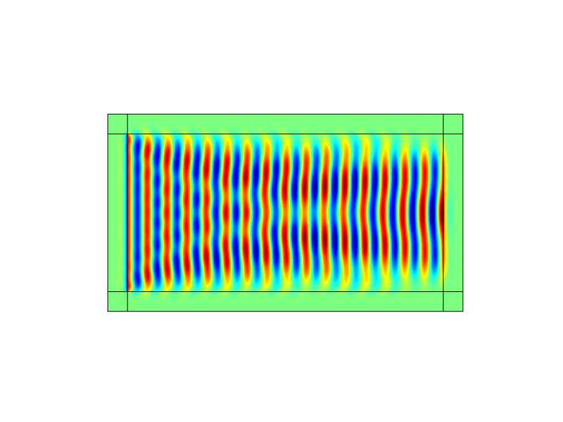

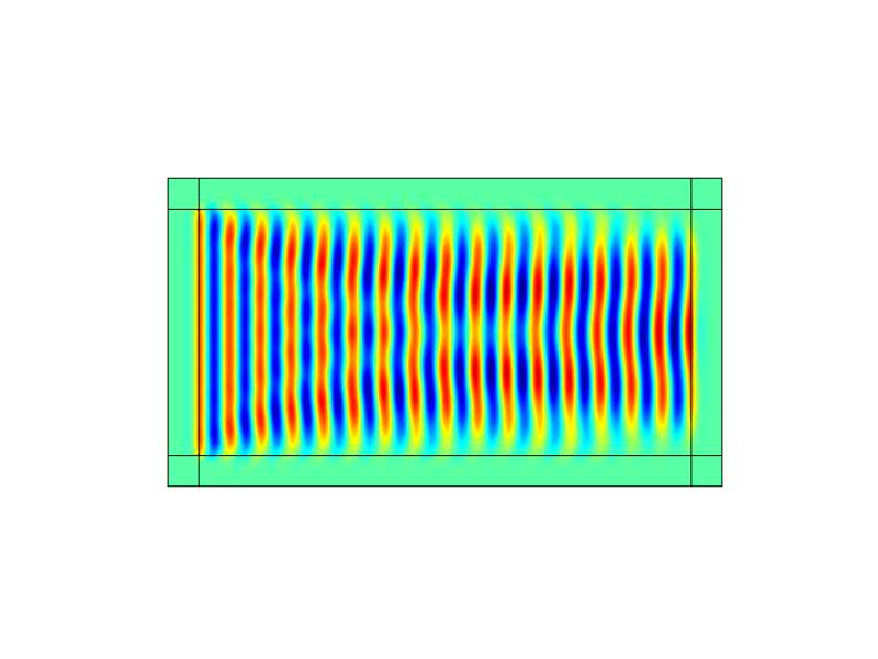

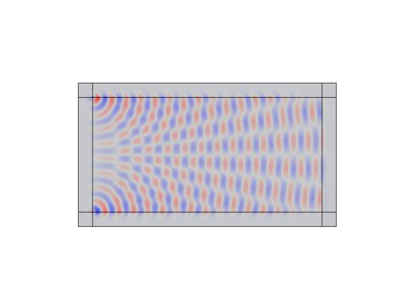

On the edge of the domain, set magnetic field Hz=1;
The domain is surrounded by Perfect matched layer.
Theoretically, there must be only Ey field, but I can see the corner diffraction pattern on the Ex field, which results on non-ideally uniform TM plane wave.
The attached files are my mph file and Ex, Ey, Hz field images.
My question is:
Can we diminish or reduce this corner diffraction effect?
Thanks in advance!
