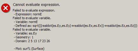

Excellent, this is exactly what I was looking for. But there is still a problem. If I use the variable (dubbed normE) as a plot expression I get an error "failed to evaluate variable" a screenshot of the error message dialog is attached. If I replace "normE" by "sqrt(realdot(es.Ex,es.Ex)+realdot(es.Ey,es.Ey)+realdot(es.Ez,es.Ez))" in the expression field the plot works without error.

Regarding the error, my guess is that you have defined the variable as a global variable under Global Definitions instead of a local (to the active model) variable under, for example, Model 1>Definitions. It is possible, but then you need the syntax mod1.es.Ex etc. to access these quantities.
