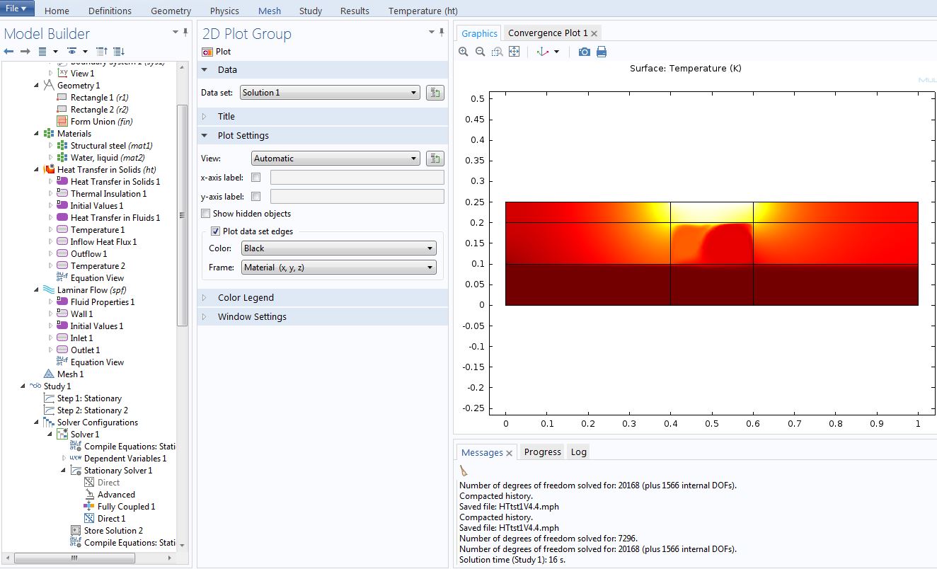

If you have a constant temperature of your inflowing fluid, just put a constant Temperature boundary in the HT and a Inlet in the fluid section + a velocity condition for the fluid (on the same "inlet boundary".
The Inflow Heat Flux is rather for convective exchange if you look at the formulas, it assumes a "virtual" domain with the temperature T at the virtual far boundary and it exchanges with your defined boundary via the heat coefficient term, and any inflow heat exchange q0
Well the nice thing with COMSOL it's easy to make a simple "test model", see below
still the strange thing is that:
1) First try with only 1 Heat inflow with q0=0 and T=T0+2/3*DT did NOT give the expected result
2) by adding in the total heat flux q0=1.24E5[W] as found for a constant Temperature input I do not get the same results, I must add a T=T0+2/3*DT/4, why "/4" ? to have the same as for a constant T BC
3) by adding a second Heat Inflow node and this time setting q0=0 and T=T0+2/3*DT I do get the expected results ?
=> is there something wrong ?, perhaps worth to repeat with a fresh model from scratch and/or ask support
update, I tried again with a fresh model, this time it works as expected: see HTtst2 (v5.1)

DT is a delta Temperature step in [K]
OK I tried it again in V4.4 => failure to converge and to include correctly the temperature of the fluid inflow, as well with a T=cte BC as for the heat influx !?
but it works in the V5.1 by insisting a bit, both as T=cte BC and as inflow with no extra Q but only a T
I would suggest that you get "support" to explain
Hi DT is a delta Temperature step in [K] OK I tried it again in V4.4 => failure to converge and to include correctly the temperature of the fluid inflow, as well with a T=cte BC as for the heat influx !? but it works in the V5.1 by insisting a bit, both as T=cte BC and as inflow with no extra Q but only a T I would suggest that you get "support" to explain -- Good luck Ivar
