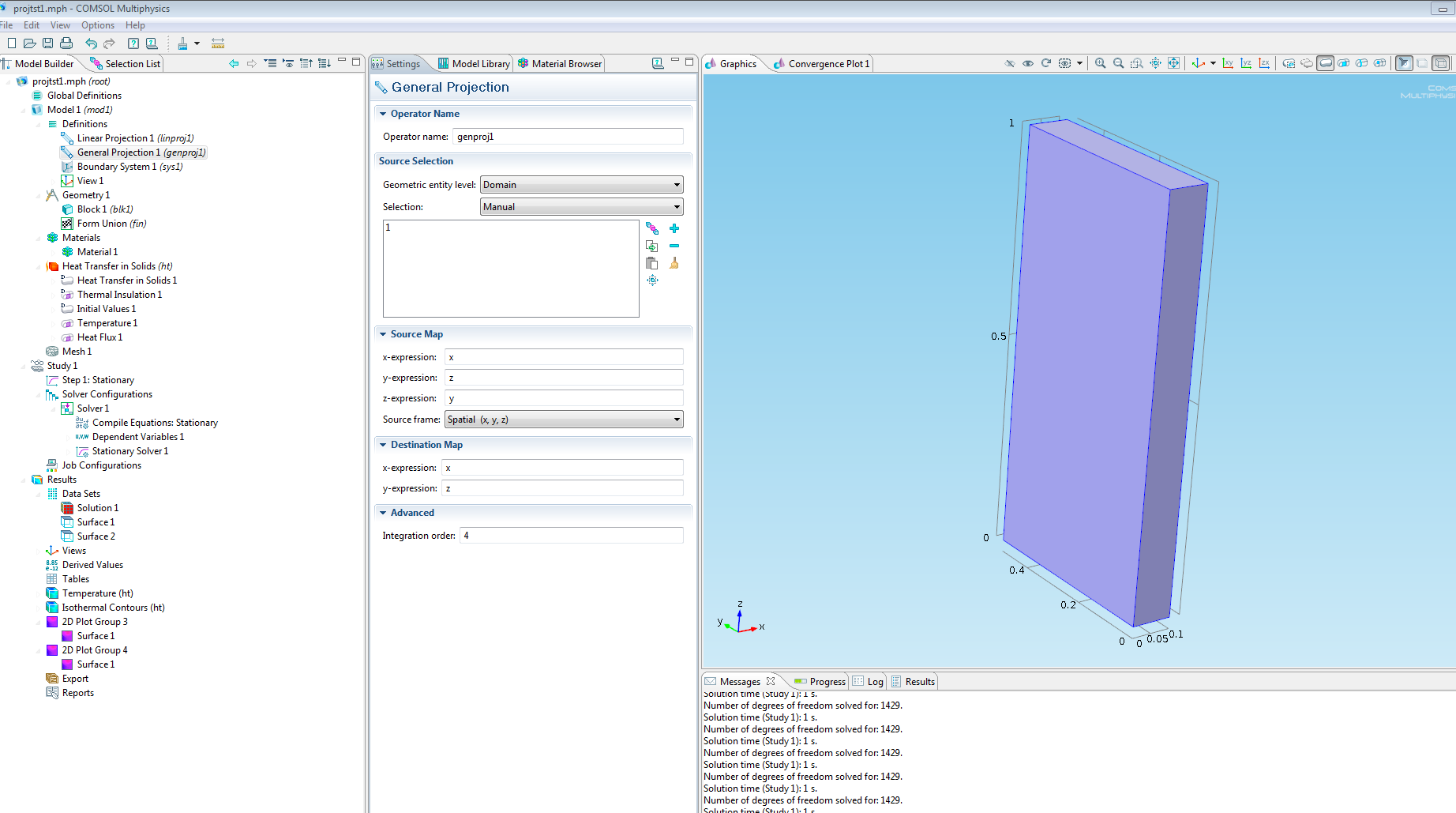

Hello All. I have a similar problem:
My domain is a 3D bloc (L*W*H), I calculate a variable C (x, y, z) in this domain.
I need to define a parameter Cs (x, y) on one face of the bloc (z=0) as the integration of C along the normal axis (z) of that face. Cs (x, y) = $(from z=0 to z=H) C(x, y, z) dz
Cs will be used in the calculation of C.
So should I define an integration? an Extrusion? is it possible?
I never understood extrusions. I though I did once, and I used it, but then I forgot, I think it is really uninuitive unclear function of COmsol:
Thanks for any help!!!
Hello All. I have a similar problem: My domain is a 3D bloc (L*W*H), I calculate a variable C (x, y, z) in this domain. I need to define a parameter Cs (x, y) on one face of the bloc (z=0) as the integration of C along the normal axis (z) of that face. Cs (x, y) = $(from z=0 to z=H) C(x, y, z) dz Cs will be used in the calculation of C. So should I define an integration? an Extrusion? is it possible? I never understood extrusions. I though I did once, and I used it, but then I forgot, I think it is really uninuitive unclear function of COmsol: Thanks for any help!!!
Posted: 1 decade ago 7 juin 2012, 09:43 UTC−4
It's rather the projection operator you should use that integrates over the last variable (if you want an average, divide by the total line length
I have attached a simple example hereby but its 4.2a ;)
Hi It's rather the projection operator you should use that integrates over the last variable (if you want an average, divide by the total line length I have attached a simple example hereby but its 4.2a ;) -- Good luck Ivar
-- Good luck Ivar
Posted: 1 decade ago 7 juin 2012, 10:04 UTC−4
Hello Ivar.
Thanks a lot! Your help is very much appreciated.
So in this case I should define Cs=genproj1(C) right?
BTW Why is it integration order 4?
PS: thanks for the information and solving my problem, but in the general case, how do I know if I need a projection or an extrusion, linear or general....? is it like 3D -> 2D = projection and 2D ->3D = extrusion? I mean what is the reason to choose those names? for me in real life, a projector takes a 2D picture and projects it in a 3D domain, pretty much the same as an extrusion, which translates a 2D shape to form a 3D volume... I'm not a native english speaker but those words are not clear to me...
Hello Ivar. Thanks a lot! Your help is very much appreciated. So in this case I should define Cs=genproj1(C) right? BTW Why is it integration order 4? PS: thanks for the information and solving my problem, but in the general case, how do I know if I need a projection or an extrusion, linear or general....? is it like 3D -> 2D = projection and 2D ->3D = extrusion? I mean what is the reason to choose those names? for me in real life, a projector takes a 2D picture and projects it in a 3D domain, pretty much the same as an extrusion, which translates a 2D shape to form a 3D volume... I'm not a native english speaker but those words are not clear to me...
Posted: 1 decade ago 8 juin 2012, 00:51 UTC−4
you can use both (generic or specific), but their set-up is slightly different, in one you use the geometry (points/vertex) in the 2nd you use the generic coordinate system topdefine the orientations and the integrand.
Note: both of them perform an integration hence you add a *1[m] on the units from the ds term. This is OK for flux or density variables, for global variables when you want an average output, you need to normalise by the integration length.
Projection and extrusion are opposite (in some sens) operations. The best is to carefully read the doc (2-3 times ;) it has taken me quite some time to catch the essence behind these operators, but I have still not found a simpler way to explain how it works, and I still make small examples as the previous posted one to check that I get the right operator and that I use it correctly
