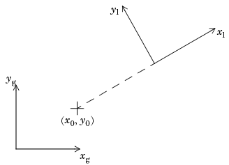

Thank your for your reply. I tried a 3D program, but failed, because of too large dof. I am gonna simulate an array of transducers, so so large mesh I could not stand. I tried a 2D(not axial symetric), it gave me a result. But I remember that 2D geometry had a thickness of 1m, which means the shape I simulated is a rectangle rather a cylinder chip transducer.
I am thinking of using a local coordinate to the cylinder, as a user defined one. Did you think that works? If it doesn't, what situation did this one used for.
I don't know what the cylinderical coordinate system is in Coordinate System Settings of Comsol 3.5a, even afer I read the user manual. What is x coordinate of origin?
As illustrated: "Cylindrical coordinate system: A local cylindrical coordinate system (xl, yl) with origin at (x0, y0) is specified.", And I attached the diagram. If I definited (x0,y0), where is the symetric axis?
Thanks again!
Daniel

when you use 2D and cylindrical coordinates (lets say at an origine of (x0,y0) then your axis is (x0,y0,0)-(x0,y0,1) along the Z out of plane direction. If you need several itms ou define several cylindrical coordinates, one per item, bu then you need to express also your equations this way. COMSOL looks normally after the coordinate transform.
For cylindrical axis, the default is X == phi=0 direction, if you do not give a "phi" offset too.
your coordinates are then r, phi (and a==z in 3D)
One of the difficulties in 3.5 is that you cannot "see" the coordinate system, that is you must define some vector along the different new coordinatesystem (such as a boundary force and visualise the initial conditions on the graphs to check that the coordinate system is OK, then you must take these dummy forces away as mostly they are not part of the model.
And do not forget that 2D is in fact 3D but with a depth (z) direction mostly set to 1[m] by dfault (hence simple unit transforms) but you can always change this depth value at will
