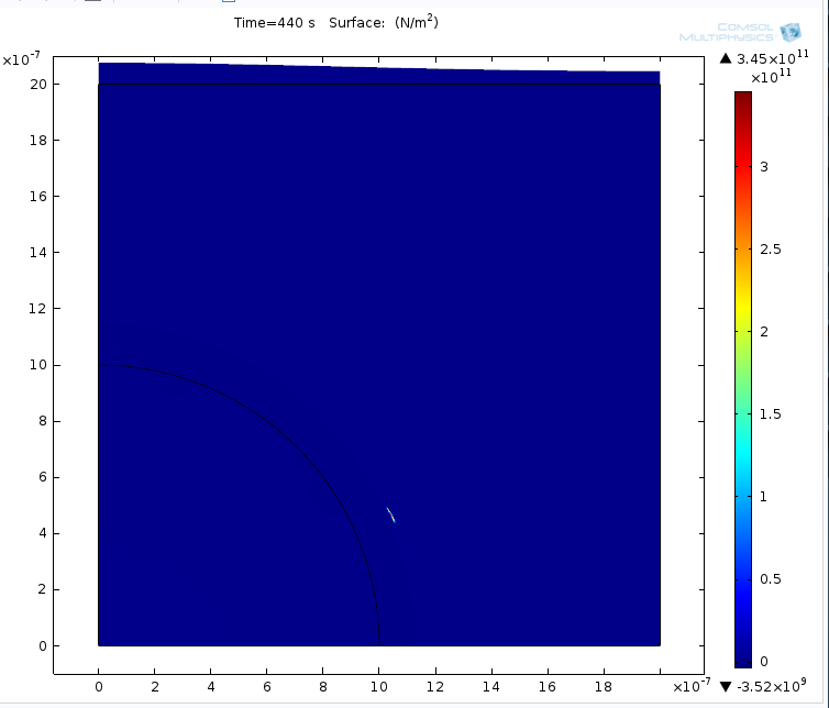

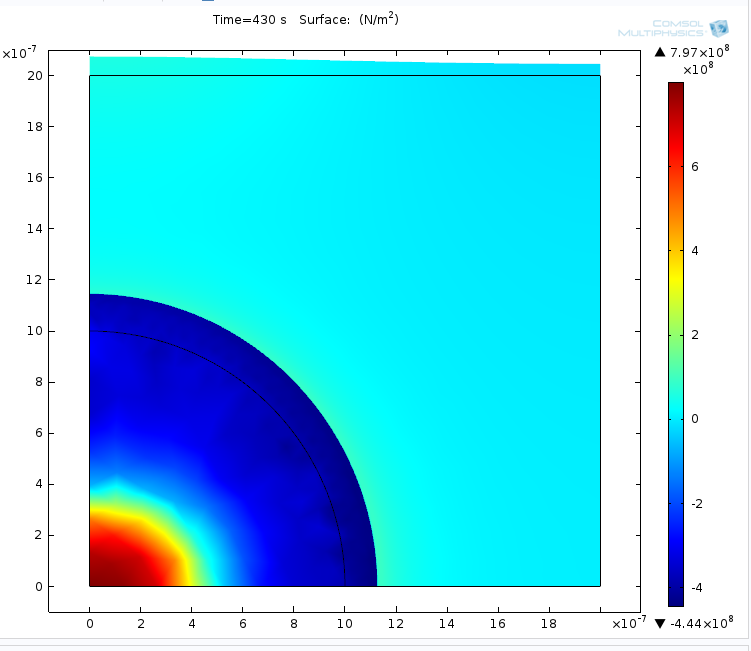

Recently I encountered a problem. When I used solid mechanics module to simulate the thermal expansion deformation of a particle-matrix system(a sphere particle included in a matrix, axi-symmetric model). I cannot converge at some time. As fig. t430 and t440 shown, when time is 430s, the result is right while when time is 440s, the calculation cannot converge. However, if I only simulate the expansion of this particle, it can work well. So I want to make sure if it is the interface causes the problem. Is there any ways to deal with it? Thanks!
Rong

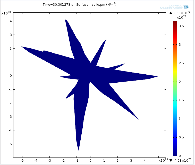

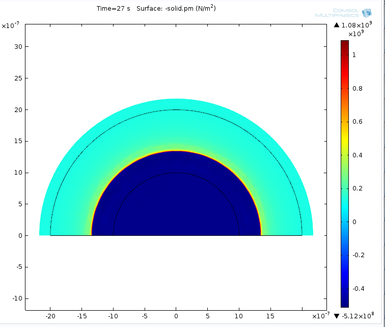

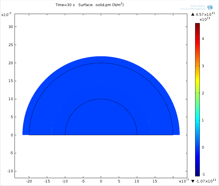

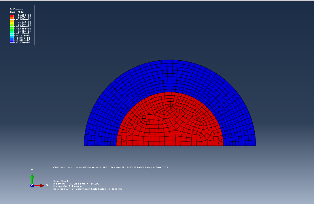

I also found when I even added a homogeneous temperature field on the center part, it cannot converge at some time. I think it is a very simple problem with large deformation, and in ABAQUS it can work well. But I don't know why I cannot handle with it in COMSOL. Attached is the pressure at different steps. Thanks!
Rong

Thanks so much! This model is just a simplified model. Even I build an axis-symmetric model (attached is that axis-symmetric model). It cannot converge yet. So I think it is not because of the axis-symmetric frame. Is it because the difference of Young's Module between two materials is two large?
According to the thermal expansion coefficient, finally I need a 50% thermal strain, so for simplification I set CTE equals to 1 and the temperature equals 50 0.5. Of cause I can define CTE as a smaller value while the temperature gradient would increase. So I think the result is the same. Thanks!
