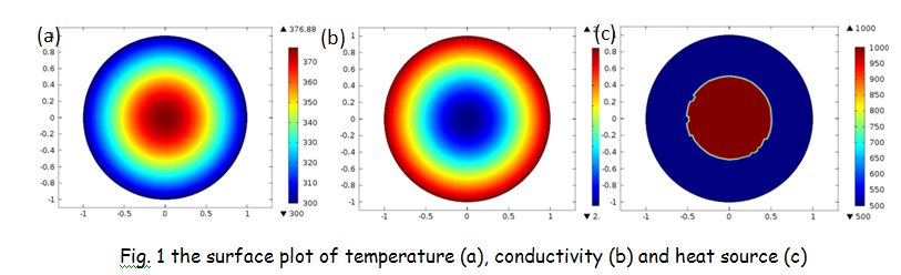

I have downloaded the .m and .mph files, and also encountered some problems. furthermore, some puzzle still exists. Is there anyone can help me? Thanks sincerely in advance.
(all the text and photos are integrated in the .doc file, please see the .doc file , thanks)
Files:
extfun_heatcond_q
source.m
thermalcond.m
The above two .m files are put in the directory of matlab, and the .mph file just on the computer desktop.
When open the “extfun_heatcond_q.mph”, I can see the surface plot (under the “Results“ branch) of heat source, conductivity, temperature, which are illustrated in Fig. 1.
Fig. 1 the surface plot of temperature (a), conductivity (b) and heat source (c)

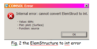

Question 2: convert ElemStructure to int error when plotting
According to the guidance from the documents (new 4.2a edition), the external matlab function can be plotted only in COMSOL (do I misunderstand?). So I add the data ranges (two data sets because there are two arguments in function) in ”plot parameters”. Then I click the “Plot” to plot the function, but fail, and the error “Internal error: cann’t convert ElemStructure to int” occurs, just like Fig. 2.
Fig. 2 the ElemStructure to int error

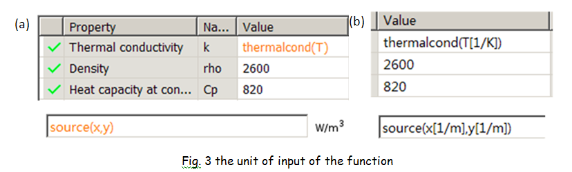

Question 3: about the unit in the material property
I check the model whole with the hope of making it clear. Then I found the thermal conductivity is defined using the external matlab function “thermalcond(T)”. While it shows orange-coloured, and implies “unexcitable unit of input”. The T in the COMSOL model have its inherent unit ‘K’, if using “thermalcond(T[1/K])” instead, the color is black (means no error). The “Heat Souce” in the Heat Transfer model node is similar. Is there any difference between them?

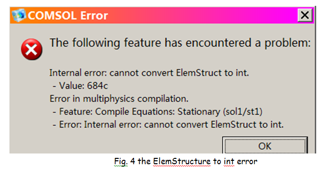

Question 4: the ElemStructure to int error again when solving
Then, I click “Study” to calculate the model. However, the following problem occurs just similar with the situation when I try to plot the function only before.

Posted: 1 decade ago 17 févr. 2015, 13:46 UTC−5
Hi all,
first, thank you for your nice explanations.
I have a slightly different problem, where I, at the end, want to integrate some variable (using mphint2 in Matlab) on the simulation volume, but in each point weighted with a factor that is given by a coordinate-dependent Matlab function.
For that I wanted to define a Matlab function in Comsol as described above and then simply call it within the expression that I want to evaluate.
As a first step I ran the example model that Lars showed here, which worked fine for me, but then I added an own Matlab function defined similar to ones that are already used in the model.
I was able to use this function within Comsol and to plot its shape (so apparently it is properly loaded and recognized by Comsol and Matlab). The problem appeared, when I then tried to evaluate this function on data stored in dataset 'dset1' so the actual simulation result.
For example:
If I would create a function that for simplicity would do nothing, but return the x coordinate, so f(x)=x.
I define it in Matlab and import it in Comsol, as already described and it seems to work.
I then add this function as a factor in the expression for the conductivity plot (which is of course nothing physical relevant).
I then would get the following error message:
Evaluation of result expression failed.
Unknown function or operator.
- Name: myfunctionname
- Plot: surf1 (Surface)
So, do you have a clue what I do wrong or any hint that I could try?
Thanks already in advance for your help.
Hannes
Hi all, first, thank you for your nice explanations. I have a slightly different problem, where I, at the end, want to integrate some variable (using mphint2 in Matlab) on the simulation volume, but in each point weighted with a factor that is given by a coordinate-dependent Matlab function. For that I wanted to define a Matlab function in Comsol as described above and then simply call it within the expression that I want to evaluate. As a first step I ran the example model that Lars showed here, which worked fine for me, but then I added an own Matlab function defined similar to ones that are already used in the model. I was able to use this function within Comsol and to plot its shape (so apparently it is properly loaded and recognized by Comsol and Matlab). The problem appeared, when I then tried to evaluate this function on data stored in dataset 'dset1' so the actual simulation result. For example: If I would create a function that for simplicity would do nothing, but return the x coordinate, so f(x)=x. I define it in Matlab and import it in Comsol, as already described and it seems to work. I then add this function as a factor in the expression for the conductivity plot (which is of course nothing physical relevant). I then would get the following error message: Evaluation of result expression failed. Unknown function or operator. - Name: myfunctionname - Plot: surf1 (Surface) So, do you have a clue what I do wrong or any hint that I could try? Thanks already in advance for your help. Best, Hannes
Posted: 1 decade ago 18 févr. 2015, 05:19 UTC−5
Hi all,
sorry for wasting your time. I got my mistake.
One can apparently just apply a function to a dataset, if the function was defined before running the respective solver.
Cheers,
Hannes
