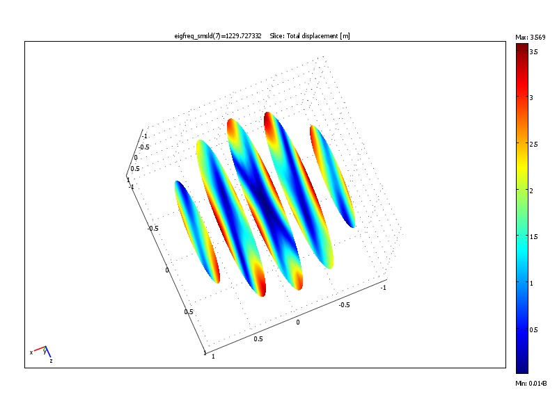

Structural Mechanics Module ->Solid, Stress-Strain -> Eigenfrequency analysis -> create a solid sphere of 1m -> set boundary constraint condition as Free -> Set Subdomains with default setting (E=2.0e11); v=0.33; a=1.2e-5; p=7850), Material model as isotropic; Coordinate system as global coordinate system; ->initialize mesh - Solve eigenfrequency -> that is.
I used Slice (predefined quantities=total displacement) to check all the frequencies found from 0-4000Hz, but were not able to find the breathing mode...
did I do anything wrong here? Help please

Hello, I am a newbie of Comsol and I tried to start with a very simple model of finding fundamental breathing mode of a solid sphere, but got frustrated - it seemed that I was not able to find the breathing mode (or don't know how to identify). The way I did is following:

thanks for your reply. I still had troubles in understanding results from Comsol. here are some more information on "breathing mode".
(1) the breathing mode of a sphere means sphere only experiences radial motion. the fundamental breathing mode of a free sphere corresponds to an expansion and contraction of the sphere along radial direction oscillations with the lowest frequency (n=0 mode). I attached an image here showing analytical calculation of n=0 and n=1 breathing mode of a sphere.
(2) As I described before I tried to use Comsol to calculate breathing mode of a sphere (R=1m with default material setting, see above), but I was not able to find the fundamental breathing mode. I attached result from comsol calculation here with lowest frequency at 1229Hz. as you can see from both slice and boundary images (total displacement) it was not so called breathing mode (which was supposed to have spherical symmetry in the motion).

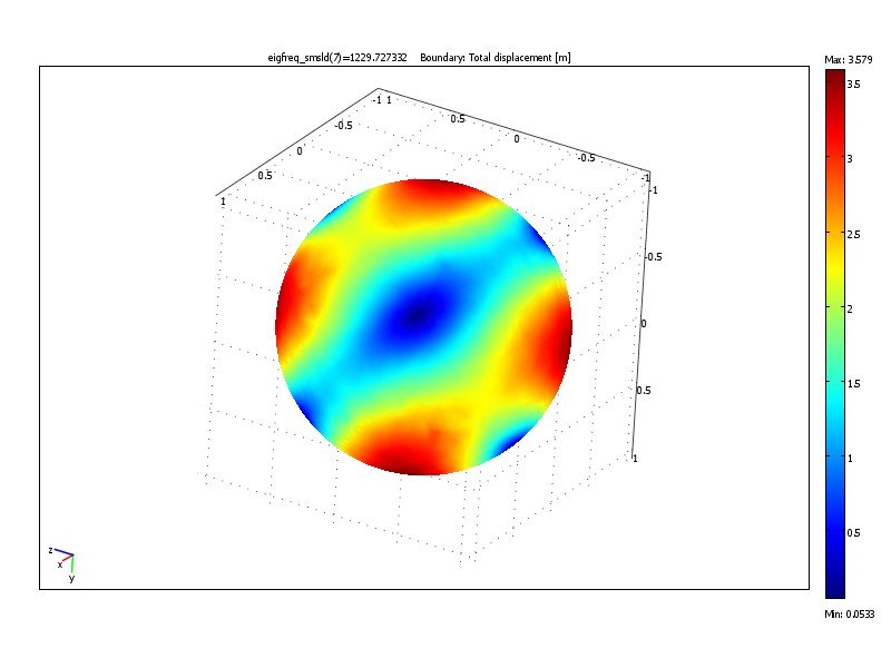

(3) you mentioned about the "deformed shape" image in your message, but I can not find it with comsol 3.5a. would you describe a little bit more detail? I only found x-displacement, y-displacement, z-displacement, total displacement and etc in the predefined quantitied...

(4) another thing I questioned about the result from comsol was that if you looked at my attached image of 1229Hz mode, the total displacement of sphere at that mode could be up to 3.5m for a R=1m sphere. does that make sense? it seemed to em the oscillation amplitude should not be that big...

I do not have time just now to answer all your questions (I'm in fact at a Comsol course, RF this time), but I have a few easy points to give you here:
Eigenfrequencies calculations: the eigenfrequencies calculated are correct from the model point of view in Hz, but total displacements are arbitrary, as eigenmode can be arbitrary normalised. COMSOL has selected one way, rather different from some other fem tools such as NASTRAN and ANSYS, but it's still mathematically correct, so you should not concentrate on the absolute values of a mode shape, only their relative shapes.

Back to your 3D simulation, I repeated it quickly, default 1m radius sphere, no BC, default material steel. I meshed it rather "finer" with 55000 elements and 231873 DoF's. It took 352 seconds on 8 core for 9 GB ram in direct defauilt settings mode. I asked for 26 first eigenmodes, and what do you see:
Observe the mode shapes in "Slice" mode with 3/1/1 slices and alternatively in "Boundary", with "Deformed" shape ON
I get 6 modes close to "0" Hz, these are the 6 free-free DoFs, as expected;
then 5 modes around 1232+/-0.5 Hz, the shape appears rather spheric with several hills appearing, allthough the numerical values shown are large, but this could be a mode normalisation effect
then 5 modes around 1305+/-0.5 Hz, the sphere show large elliptic deformations, more like an egg,
then 2 modes around 1767 Hz, 1 at 1777, 2 at about 1900, 2 at 1903, 2 at 1905 and one or more at 1912 Hz
