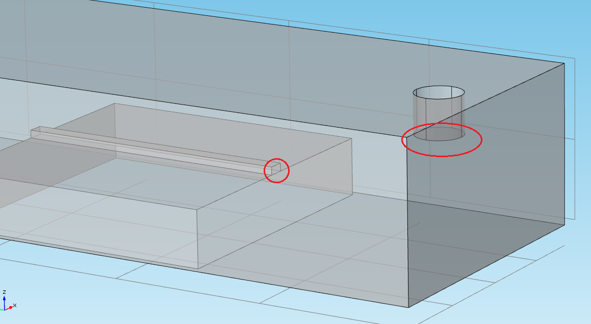

I am designing an encapsulation for a chip and I need to create a flow path through it.
The starting surface of the flow path is a circular surface and it should finish in a rectangular surface.
I am trying to figure out how to do this but I have not had success on this.
If somebody could help, it would be great.
Attached there is a picture of the design and in red you will find the surface that I want to unify.

I think the easiest way is to build this in a CAD program like Creo and do a swept blend.
Posted: 1 decade ago 12 juin 2015, 14:16 UTC+2
Thanks for your reply. I think you are right, I already changed to SolidWorks to design the structure.
