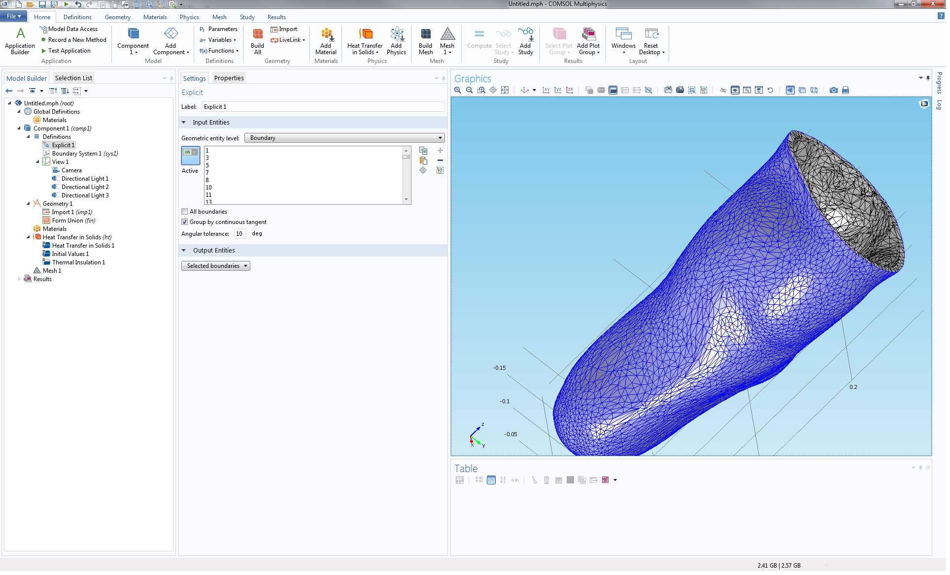

How about using selections with the "Group by continuous tangent" checkbox on? See attached screenshot for an example of how to group all the outer faces.
Hi Rhys, How about using selections with the "Group by continuous tangent" checkbox on? See attached screenshot for an example of how to group all the outer faces. Jeff
