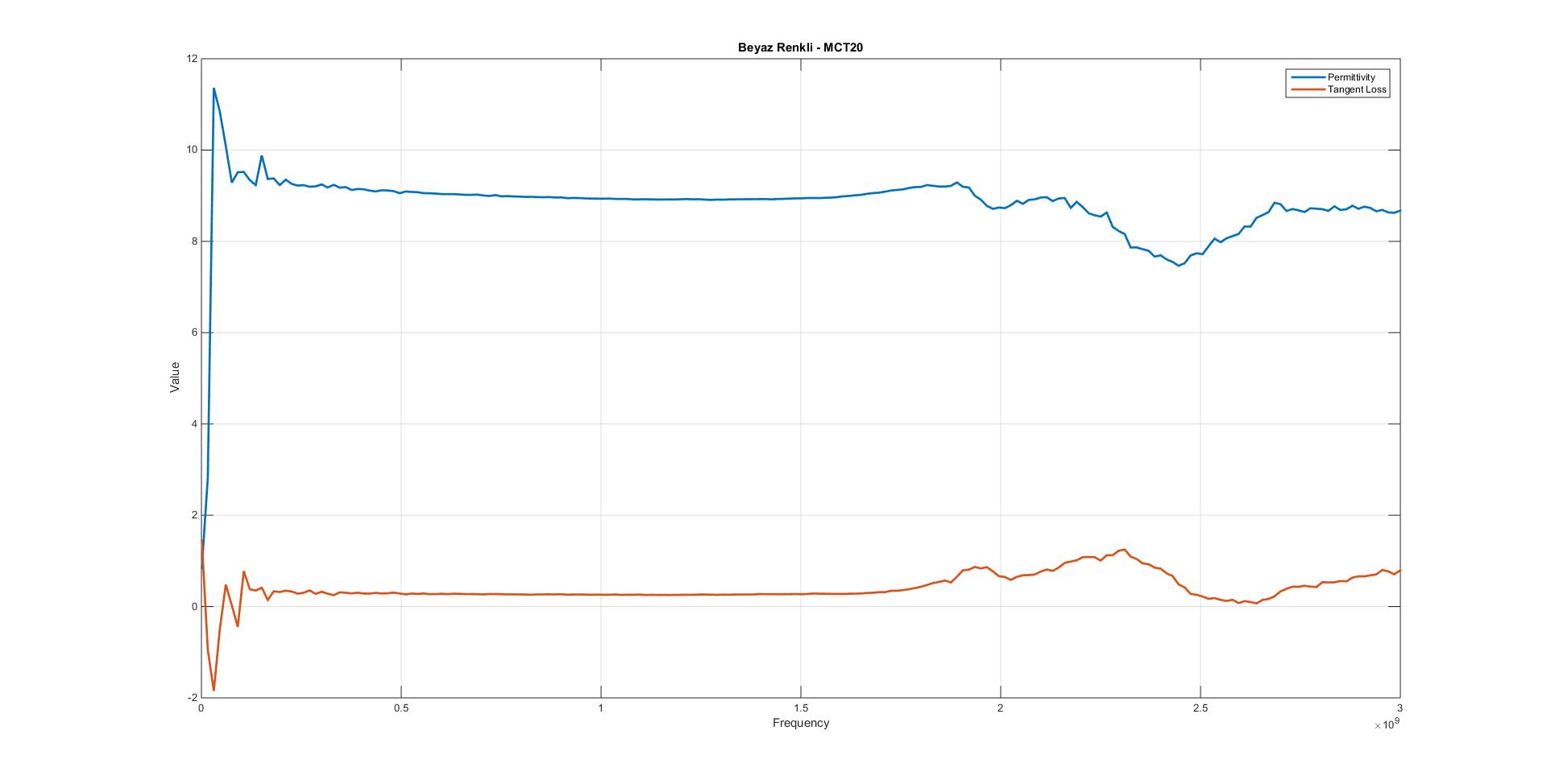

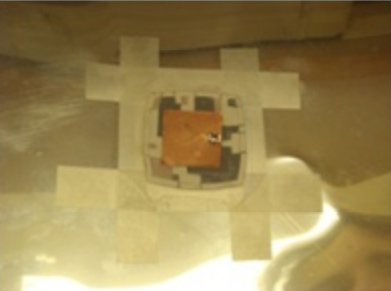

First of all thank you so much for your kind response.
The antenna that I am trying to simulate is a fabricated out of with special materials. It contains different material subdomains in it (Fig1). Actually I was suspecting with its material properties however after re-measurements I have found similar results that I assigned as a material. (diel1, diel2 and diel3).
What would be the problem you think?
Best regards.
Best regards.

                                                    Hi Hakan,
The antenna that i was trying to simulate, had a high dielectric material and complex shape as you see. So later on I designed a very simple patch antenna with duroid substrate and results matched very well with the measurement.
                            Hi Hakan,
