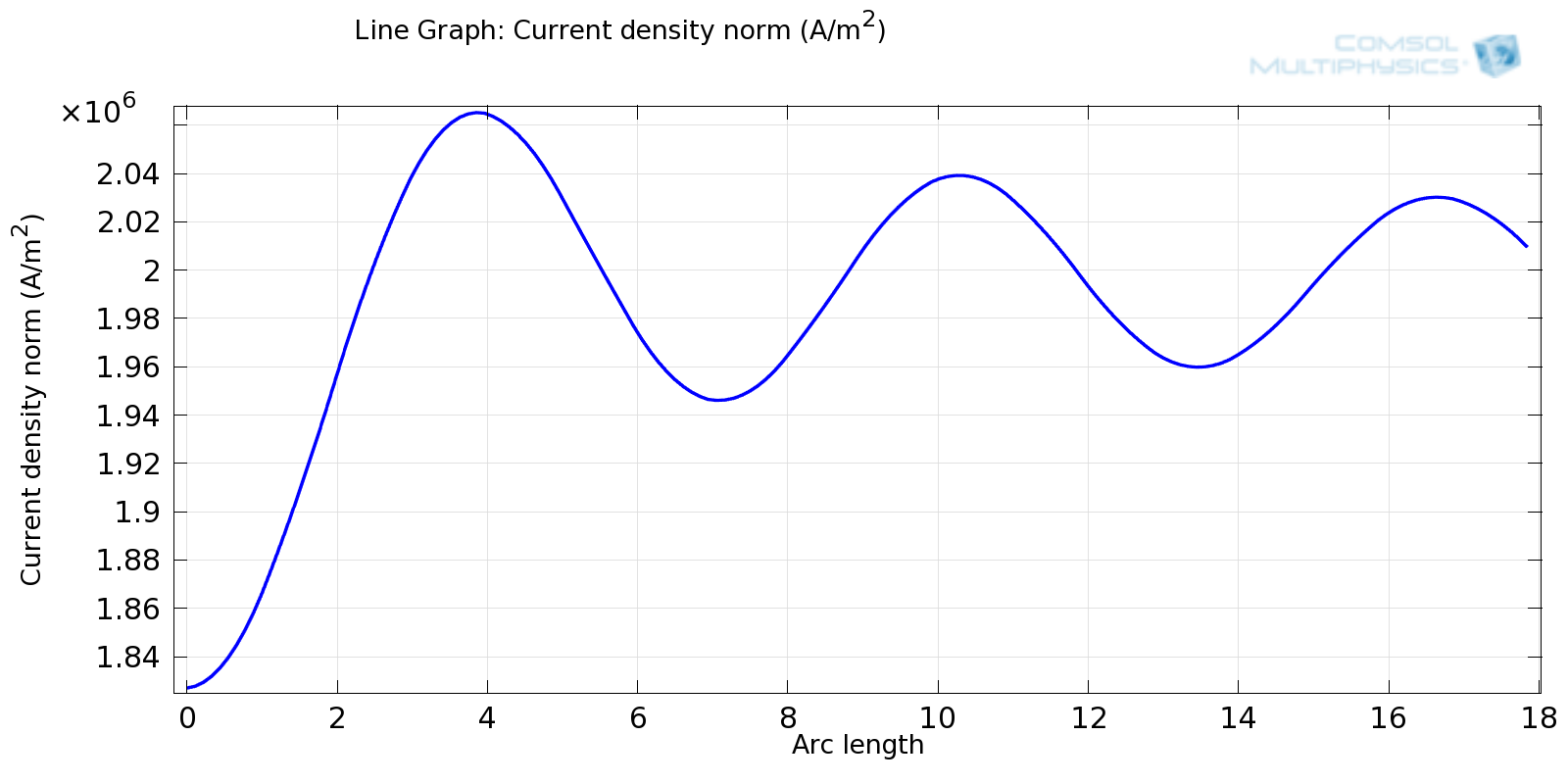

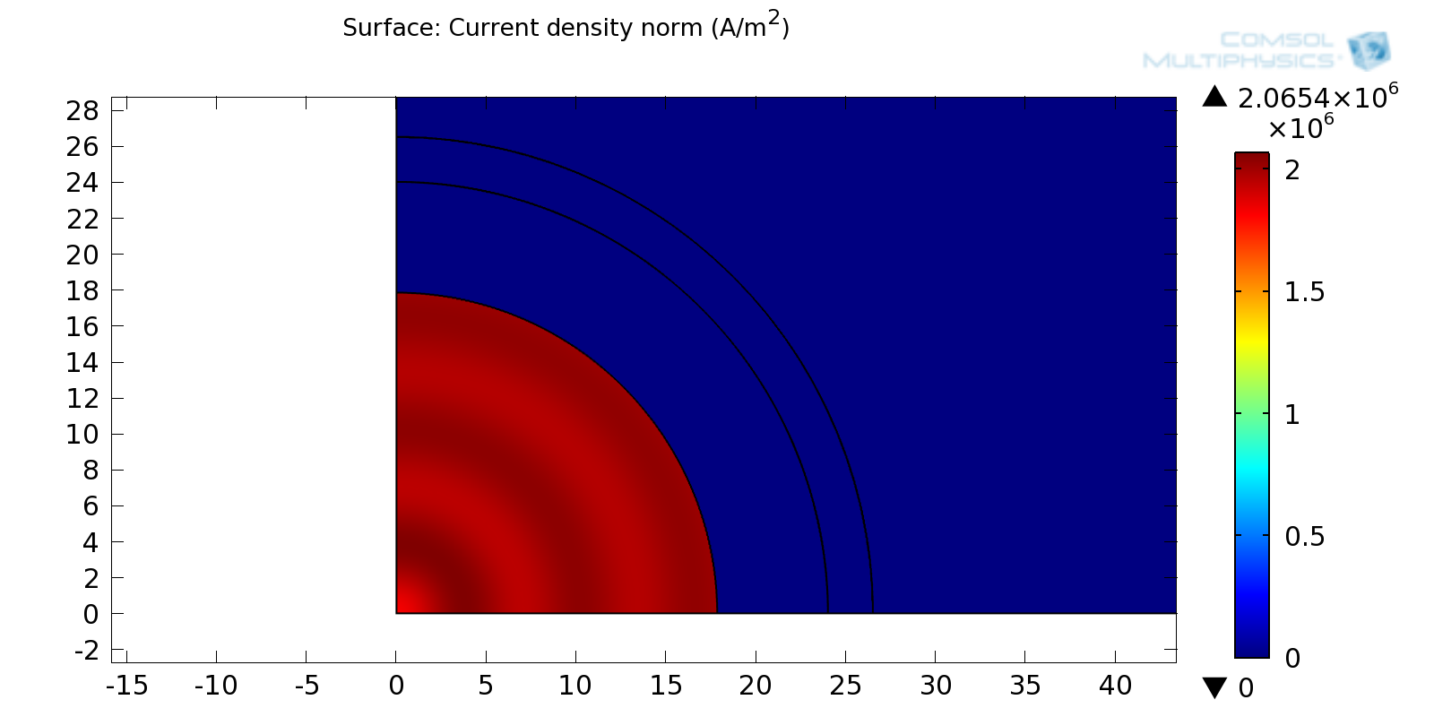

At very low frequencies, the AC model looks like the DC case, but a I increase the frequency the results become less and less like what I would expect. I've attached images showing the current density distribution in the copper at 5Hz. When I check the total current through the cable after the simulation, the global constraint does appear to be working with regards to the total current, but the distribution does not show the skin effect, but just some kind of simulation artefacts.

After much trial and error I managed to solve this problem, so I'll briefly outline my solution below in case anyone else has the same problem.
1) The rather strange solution seemed to be caused by some kind of corruption in the file, as I was unable to make any progress until I created a new file and started from scratch.
2) Add the Magnetic Fields (mf), Heat Transfer (ht), and Global ODEs and DAEs (ge) physics.
3) Create a frequency study and deselect the ht physics. Then add a stationary study and deselect the mf and ge physics.
4) Show the default solver and add Other > Store Solution after Stationary Solver 1: this is needed to get the results from mf, such as current density.
5) Under Global Definitions > Parameters add I_target 2000A.
6) Under Model 1 > Definitions create an integration operator for the conductor cross section.
7) Under ge > Global Equations 1 add I_ext intop1(mf.Jz)-I_target.
8) Add mf > External Current Density and set the z component of Je to I_ext/intop1(1).
Everything else was as before, and this seems to be working perfectly.
I hope this is useful to someone else.
