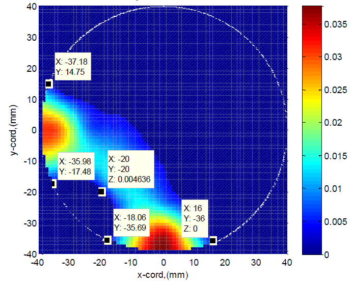

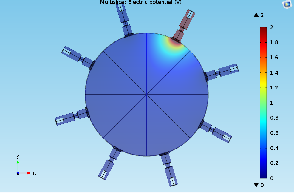

Attached is a picture of my model and those sensitive regions have coordinates;
1. I would like to know where to read the values of the centre of mass.
2 Also be able to read the x,y,z coordinates of those sensitive regions like the second photo attached.
Thanks tons.
