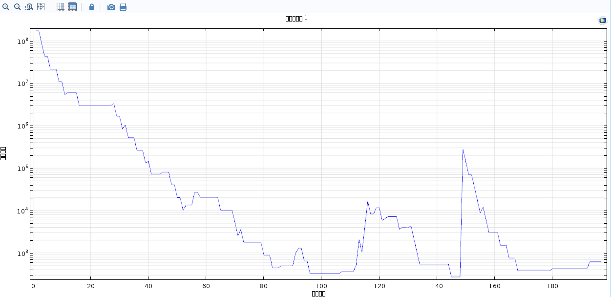

My model : the part of core apply BH curve, I feel COMSOL calculate such problems are difficult,could you provide me some advises for the problems

To solve a non-linear time dependent problems like this, we do recommend that you modify the Time Dependent solver as suggested in this Knowledge Based Entry:
www.comsol.com/support/knowledgebase/1127/
