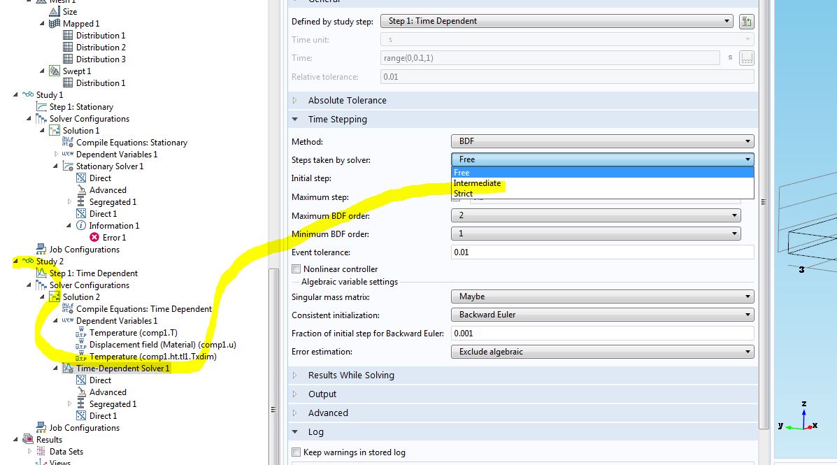

I was wondering if someone with more experience than me with the heat transfer module in solids can help with the following.
I have a heat source that dissipates power following a sine waveform. Then, I am checking the temperature at some distances from the heater and it turns out that the temperature changes like a triangular waveform; I expected a sine waveform. Although I’ve changed the number of steps of the time-dependent analysis, the thermal signal is always triangular.
Does anybody know which could be the problem with my simulations?
Thanks in advance!
F.

I see two possibilities:
a) either you have a very special geometrical shape and material properties
but far more likely
b) your time stepper is in "free" mode and the internal solver algorithm is aliasing your time dependent sinus waveform
Use the Time stepping "Intermediate" settings and ensure you have mat least 5 time step per sinus period
Hi I see two possibilities: a) either you have a very special geometrical shape and material properties but far more likely b) your time stepper is in "free" mode and the internal solver algorithm is aliasing your time dependent sinus waveform Use the Time stepping "Intermediate" settings and ensure you have mat least 5 time step per sinus period -- Good luck Ivar

Thanks Ivar!
It works, I got the sine wave thermal signal by changing the time stepper!!
Thanks Ivar! It works, I got the sine wave thermal signal by changing the time stepper!!
