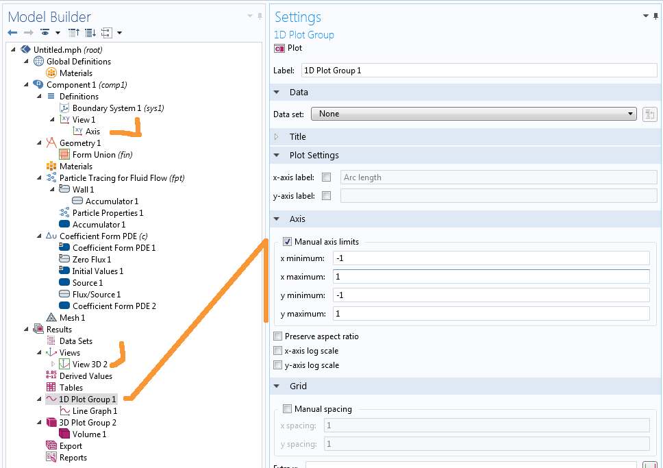

How do we set the axis in comsol 5?
I want to limit the x,y axis in comosl 5? I cant find a way to set the axis manually.

Dear Ash,
that would be under the "view node" in the definitions.
Sometimes this node is present in post processing as well. This happens when the component dimension is different than the plot you are creating (3D component and 2D plot).
For 1D plots you can change the axis limits in the "plot group node".
I hope this helps.
Frank
Dear Ash, that would be under the "view node" in the definitions. Sometimes this node is present in post processing as well. This happens when the component dimension is different than the plot you are creating (3D component and 2D plot). For 1D plots you can change the axis limits in the "plot group node". I hope this helps. Best regards, Frank

Thank you very much!
it worked
Thank you very much! it worked
