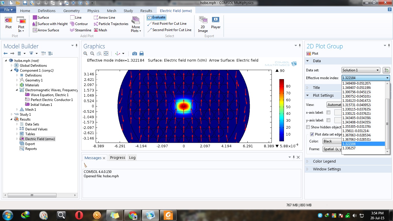

Effective index imaginary part doesn't appear.
I am trying to measure the confinement loss in a photonic crystal fiber using the fundamental mode effective index. for a wavelength 1.55um and upwards, the fundamental mode has an inedx of 1.270578-1.825e-10i , which means I could calculate the confinement loss from the imaginary part. But for any smaller wavelength, the effective index of fundamental mode becomes real. It seems like COMSOL isn't calculating imaginary part below e-10i range.
Any solution to this problem ?

Thank you. So you are saying this is not an issue with the PML, or giving any imaginary refractive index to the cladding material ?
but confinement loss comes from the equation- Loss= 40*pi*Im[neff]/(loge(10)*L) dB/km. I could only measure losses of order 1e-3 dB/km only if the imag(neff) is of order ie-11. How do you advise to calculate it then ?
Hi Thank you. So you are saying this is not an issue with the PML, or giving any imaginary refractive index to the cladding material ? but confinement loss comes from the equation- Loss= 40*pi*Im[neff]/(loge(10)*L) dB/km. I could only measure losses of order 1e-3 dB/km only if the imag(neff) is of order ie-11. How do you advise to calculate it then ?

Posted: 10 years ago 1 janv. 2016, 14:56 UTC+1
Hi, have you solved this problem, I also have this issues, it would be nice to get your advice.
Thanks.
Hi, have you solved this problem, I also have this issues, it would be nice to get your advice. Thanks.
Posted: 9 years ago 28 mars 2016, 20:52 UTC+2
Yes, later i found that the imaginary part in fact existed, but it was too small for COMSOL to calculate. anything below 10^-9 doesn't seem to appear in comsol. Change the deciding parameters like wavelength and you'll see the imaginary part starts to appear after a certain increase or decrease of the parameter.
