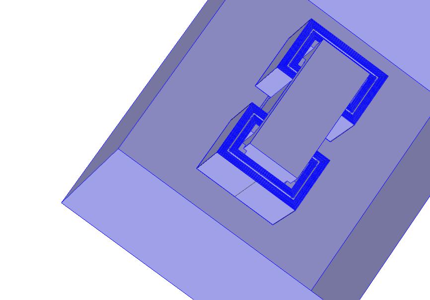

Hi Nirmal,
Thank you for comment.
I got it done already. but now I need your comment on the 3D model of the same design.
The problem here is apparently related to the meshing of domain 1 only when doing automatic meshing. Domain-1 is the surrounding air volume of inductor enclosed with the block as shown in Image-1. Also this domain includes the air between the consecutive winding layers, reference to Image-2.
I have tried applying 'Swept' to Winding and Insulation and 'FreeTetra' to others but that leads to problem in boundary respecting with issue in domain 1 as it is.
Any suggestions?
