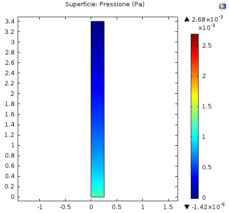

I'm simulating air in a tube (laminar flow)
In 'laminar flow' section I've chosen 'incompressible flow' (I've got an italian version of comsol, so maybe it's not right this one th english option... anyway, i've chosen the incompressible option)
Then in 'reference pressure level' (I hope this is the english name) I've chosen pref = 1[atm]
Then I've put v = 0.045 m/, buil the mesh and so on.
In the picture you see the result
Isn't it strange? I'm expecting P = 1atm somewhere...!
Anyway, my problem is: I want the pressure to be 1 atm at the inlet. I absolutely need it to be 1 atm. So maybe choosing 1 atm in reference pressure level is not the correct way....
what should i do?
what should i do?
