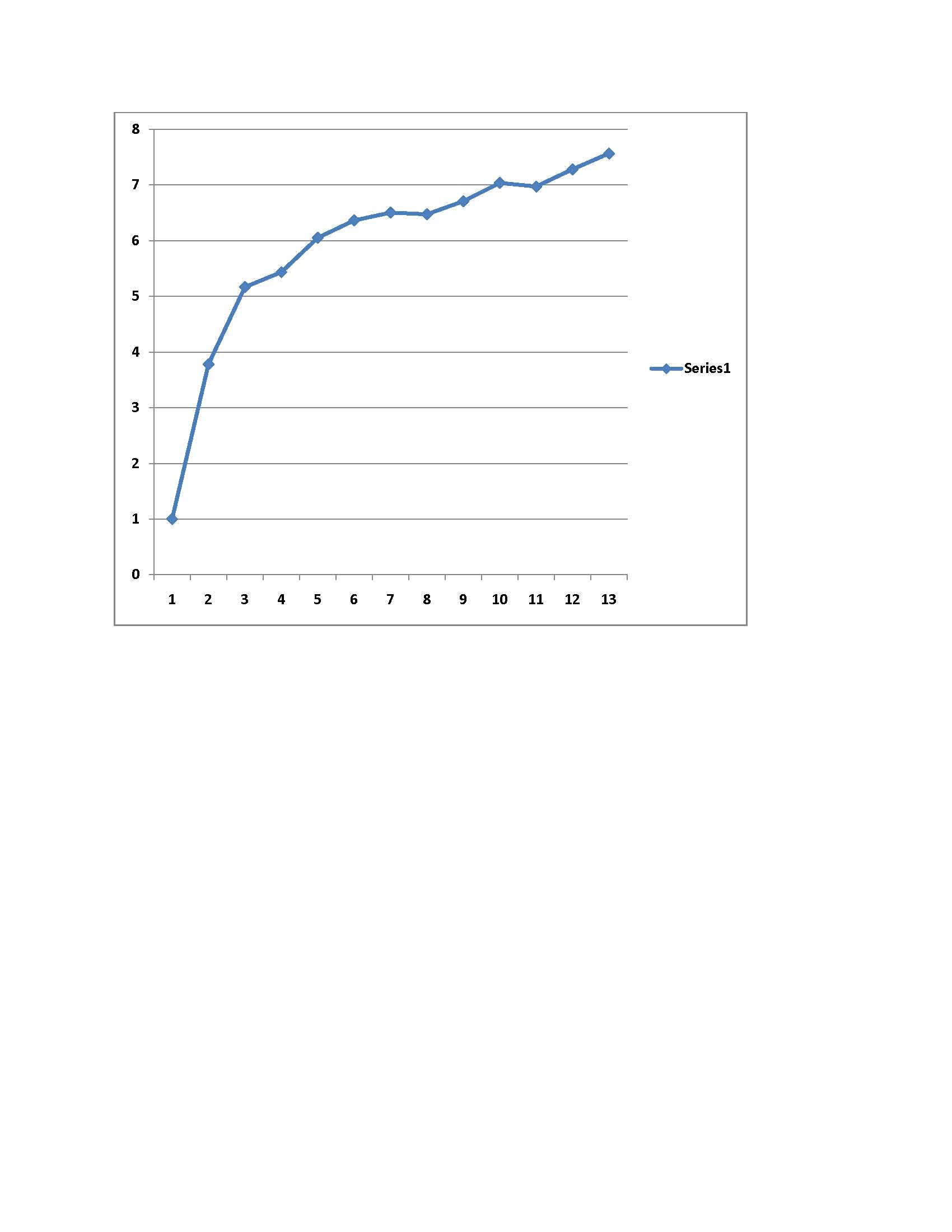

This is quite an interesting topic for me now.
I have a FSI model, and did a steady-state run on my model on a 48 core ~300GB ram, with 500k DOF.
The results are crazy. It seems if I want to do 50 simulations it is the best to run 50 single cores! I have optimized the Pardiso solver to the maximum possible speedup.
Attached are my results.
aka. A real disappointment.
Comsol 4.1
Ubuntu 10.04.1
This is quite an interesting topic for me now. I have a FSI model, and did a steady-state run on my model on a 48 core ~300GB ram, with 500k DOF. The results are crazy. It seems if I want to do 50 simulations it is the best to run 50 single cores! I have optimized the Pardiso solver to the maximum possible speedup. Attached are my results. aka. A real disappointment. -- Comsol 4.1 Ubuntu 10.04.1

Danial,
I don't think that should be too much of a surprise to anyone. Here is why:
When you write parallel code you have some sections which can be done in parallel, and other that must be done in serial. Because of this, the best parallel programs could ever hope for is to have each core running all the time. So when you run real code, and some cores have to run less time to wait for others to catch up to do the serial parts you loose that cpu time. If you run 50 instances of a single core program, each program can use the one core, and never have to wait for the other cores. It is disappointing I know, but effective CPU out put for parallel tasks scales at a power less than 1, always.
Danial, I don't think that should be too much of a surprise to anyone. Here is why: When you write parallel code you have some sections which can be done in parallel, and other that must be done in serial. Because of this, the best parallel programs could ever hope for is to have each core running all the time. So when you run real code, and some cores have to run less time to wait for others to catch up to do the serial parts you loose that cpu time. If you run 50 instances of a single core program, each program can use the one core, and never have to wait for the other cores. It is disappointing I know, but effective CPU out put for parallel tasks scales at a power less than 1, always.

Posted: 1 decade ago 8 févr. 2011, 22:44 UTC+1
Danial, in your case where you only have a single node, but several cores using the same shared memory, then PARDISO will be best. It will run in parallel on all your cores. We have a similar machine and see much better than your speedup on a problem large enough to fill the memory, but not use any disk swapping.
The latest result I have for distributed parallel processing on a multi-node cluster using both shared memory (per node) and distributed parallel processing we see a speedup of ~ 7.5 across 12 nodes and 96 cores. If we had more cores in our cluster, the speedup would be better because it has not rolled over yet. See attached plot. This cluster uses infiniband to communicate between nodes which helps tremendously. Also, across the nodes, the memory requirements are reduced significantly.
I see your scaling plot now. I am a little confused. You say you have a single-node shared memory machine. However, you also say you have 48 nodes available with a np=1. Perhaps we should be clear on terminology. We do agree that a node is a separate computer. So, if you have 48 nodes, that means you have a cluster with 48 separate computers in it. This is configured in COMSOL using the nn switch. Then, within each node, you have a number of cores on any number of processors all sharing memory. This is configured in COMSOL using the np switch. Is this also your understanding ?
If you are running all those cores on a single node, perhaps your hardware communication bus has saturated. What is the bus speed ?
As you can see from the plot I attached, I get nearly 400% speedup (compared to your 20-30% speedup) on only 8 cores and single node with np=8.
You must be doing something different.

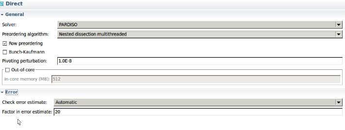

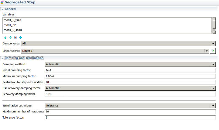

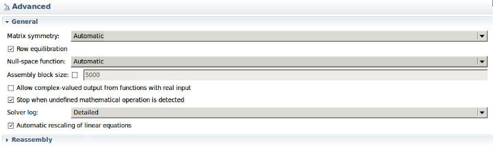

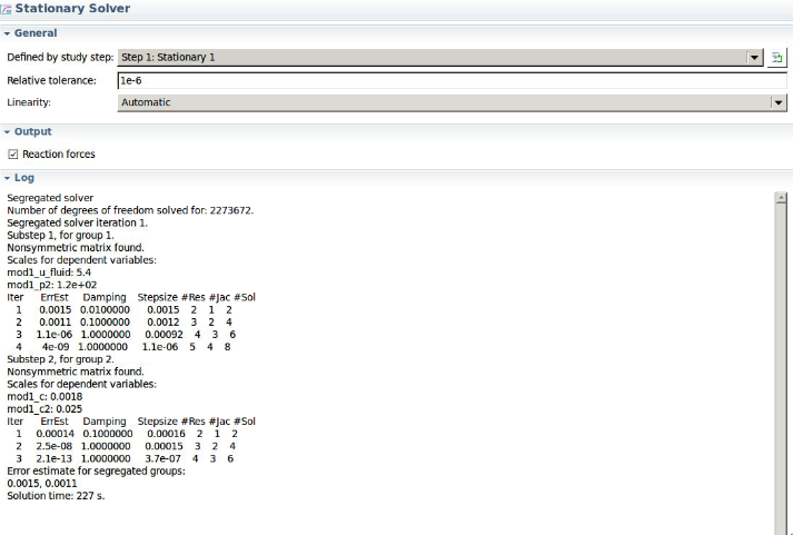

Here is the solver configuration (steady-state) with a sample log file.
Here I am using a segregated solver to add another PDE to solve (variable c), but in my tests above I have a fully coupled solver (without the second PDE) with single F.S.I physics.
Comsol 4.1
Ubuntu 10.04.1
Here is the solver configuration (steady-state) with a sample log file. Here I am using a segregated solver to add another PDE to solve (variable c), but in my tests above I have a fully coupled solver (without the second PDE) with single F.S.I physics. -- Comsol 4.1 Ubuntu 10.04.1

Danial, I cannot tell from the information you sent what the computer bus speed is. How many processors do you have that hold the 48 cores ? Do you have 48 physical cores ? On our linux box here, we have 6 cores on each of two processors for a total of 12 physical cores. However, the linux operating system takes advantage of the "hyperthreading" feature of Intel processors which appears to the operating system to look like 24 cores (doubles the number of cores to the operating system, even though there are only 12 physical cores). We have found that hyperthreading actually only give us about 30% of a physical core. So, the most we could theoretically gain with this system is a speedup of (12*1.3) or 15.6 not 24. It is better than nothing, but hyperthreading can be misleading if you don't know what you have in the box. Is your OS using hyperthreading ? Is the bios on the box set to enable hyperthreading ?
If you have 8 physical cores on a processor, that would be 6 processors in your box without hyperthreading.
If you have 6 cores on a processor, with 4 processors in the box and hyperthreading enabled, that would be 48 and that might explain at least part of your problem. This would be my guess. I have not seen a 48-physical-core single node before.

Danial, another explanation could be your problem size and type. Is your problem 3D ? It is running very fast at only 227 cpu sec for a single iteration. How much memory is your problem using for > 2Mdof ? On the problem I just showed you, we have 1 Mdof, it takes about 20 GB of memory, 47286.764 cpu sec, to run 21 segregated-step iterations on a single node using the MUMPS direct solver. If you run on multiple nodes, the memory requirement drop down significantly per node (about 8 GB for the 12-node case).
Your problem may not be running long enough in the solver to see any speedup. It should be spending most of the time in PARDISO to see a speedup (or MUMPS if running a cluster).
Also, the other codes you mention are probably using explicit methods to solve. This takes many more iterations to converge. COMSOL is an implicit method, which uses far less iterations, but at the price or more memory.

Hi James and Danial,
I am also working on the same 48-cores Linux server where Danial did some of the scaling experiments, so I can confirm what he mentioned and also reinforce this with other observations.
I have a rather large 3-D problem (coupled flow with mass transport) that can fill all the memory (~256 Gb), and still the parallel performance is bad.
Just to illustrate what I want to say, I ran a quick (smaller) test a few minutes ago (~8 Gb and -np 8).
The problem is that Pardiso works only part of the time in parallel:
-> Solving the linear system starts with the assembly (~1 min), done fast enough,
-> Then in the matrix factorization step the solver spends ~10 min doing something on 1 core. This was checked with 'htop'. Pardiso evolution counter stays all the time at 0 % in this first phase.
-> Finally, you have the parallelized part working on 8 cores, done in ~3 min. In this stage only, the counter advances from 0% to 100%. Indeed, this second phase of the solution process is gaining speed with more cores, but the first phase is limiting. You can imagine that for the "real" problem this is even more bothering.
Comsol recommends iterative solvers for large 3-D problems.
However, no iterative solver could work on my problem - at all. Neither the Comsol support could give me an answer why is that.
So, if we want to speed-up the parallel solution with direct solvers, we should "get rid" of the first phase of Pardiso. MUMPS does exactly the same. Could it be the preordering?
Cristian

Yes, I can confirm that the row preordering was the limiting step (because not done in parallel) !
Switching it off improved dramatically the solution time, without compromizing the quality of solution (for my problem, at least).
I will try to show you later also the scaling tests.
Cristian

One suggestion to save some additional clock time. You might expand your solver scheme to use the segregated solver, while still using the PARDISO direct solver within each segregated step. You could first separate into two steps: 1) the u-p laminar flow (u,v,w,p) and 2) the remaining variables. This will likely take more iterations, but still save overall cpu/clock time. You may also be able to break down the 2nd step further in some cases.
James, using a segregated solver seemed to me possible initially. However, the problem is too "strongly" coupled (velocity u affects concentration c and c affects u, as well). I tried segregated solution and it did not work at all. It is better for weakly coupled equations (only u=>c, for example).
Anyway, thanks for the suggestion.
I am still trying to make the iterative solvers work, but this is not a problem for this queue...

I have seen your results. This trend is highly probable if your problem size is comparatively small for single core itself. What happens is, if you further try to partition the problem into smaller ones, there would be lot of communication overhead among cores compared to the computation. This could hamper your overall parallel performance.
