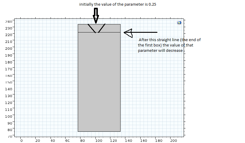

I am trying to make a function that will gradually decrease a value of a given parameter for example: At the top of a rectangular box, the initial value of a parameter will be 0.25 but it will decrease with time when the solver advances with time and at the bottom of the rectangular box the value of that parameter will become 0.001. The final value is not fixed. It can be anything. So, the value of the parameter will decrease at a controlled rate.
If you do not understand my description, please see the graphical description in the attachment. It will give you a better idea of my problem.
Does anybody know how I can make such a function in COMSOL? Thanks in advance.

A parameter can't do that. But you can define a variable on the domain that depends on y, e.g.:
var(y) = 0.25 - (220-y)/220*(y<220)
