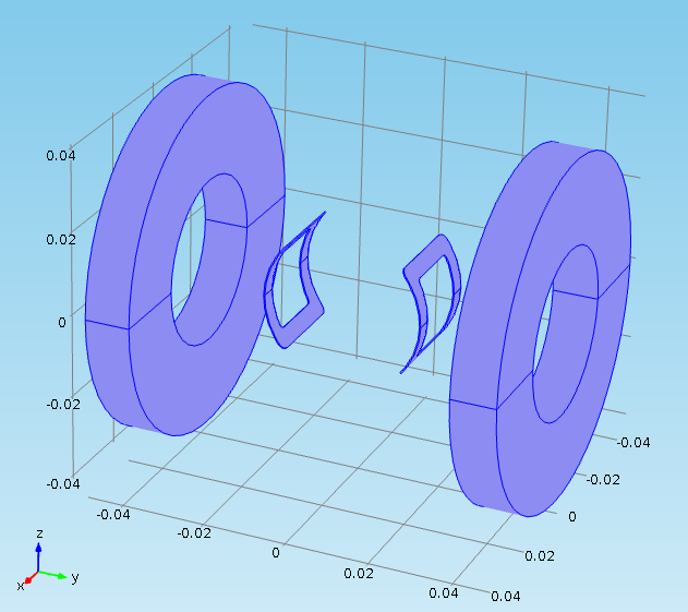

I use COMSOL to simulate induced voltages in saddle shaped detection coils (this is the reason why I have to use COMSOL - it is the only real 3D simulation software for which I have a license at the moment). Nirmal Paudel (COMSOL employee) was kind enough to point me to the secret of the electrical conductivity of air which apparently must not be smaller than 1e-1 S/m in my frequency domain study. Otherwise the biconjugate gradient solver does not converge - for whatever reason (I would be very grateful if someone is able to explain me why since the real electrical conductivity of air is in the range of 1e-15 S/m). Like I already described in my referenced post (see above) I was not able to understand the simulation results of my splitted Helmholtz coil model because a symmetric model and a symmetric magnetic field must theoretically end in identical induced voltages in symmetric detection coils - but they're different. I reduced my model to not-splitted Helmholtz coils and at least both induced voltages fit theoretical considerations with respect to the curve trend U = f(freq) but not to the range of values I think. Hereupon I implemented a new (simple and reduced) model (see attached image: coils.png) and the induced voltage in the saddle coils changes its direction over the given frequency range freq = 1kHz up to 25kHz (see the other attached image: induced_voltages_U_freq.png). I will attach my *.mph file and I hope that someone is that kind that she or he will take the time to look into my files. I would be so grateful if someone could show me my big mistakes.

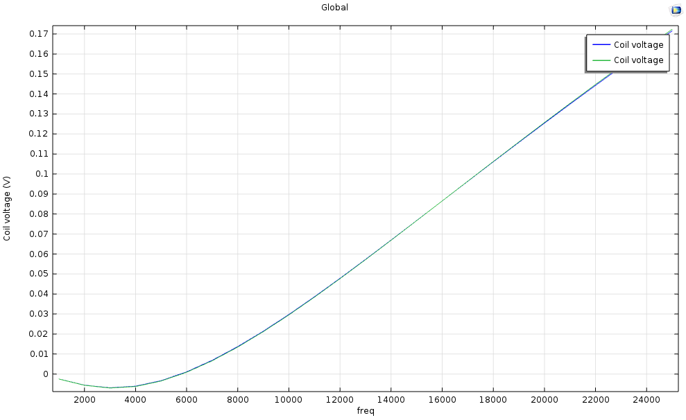

Thank you for your use, Edgar. I tried to simulate a second time and the results do not change. Is it important to follow a specific order of the "Magnetic Fields" item steps? I attached my model with the gauge fixing for A-field. Maybe you can see any differences between your modifications and mine? Like you see in my attached image I only determine a linear dependence of induced voltage and frequency between 10kHz and 25kHz.
Thank you for your effort again,
Sebastian
Thank you for your use, Edgar. I tried to simulate a second time and the results do not change. Is it important to follow a specific order of the "Magnetic Fields" item steps? I attached my model with the gauge fixing for A-field. Maybe you can see any differences between your modifications and mine? Like you see in my attached image I only determine a linear dependence of induced voltage and frequency between 10kHz and 25kHz. Thank you for your effort again, Sebastian

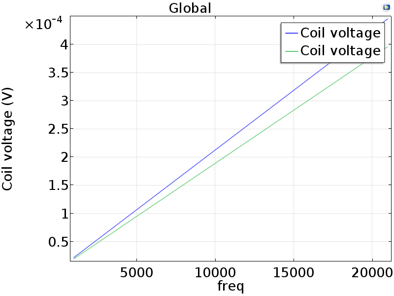

this is what In get when I run your model in 5.1. -- Edgar J. Kaiser emPhys Physical Technology http://www.emphys.com

thank you for your reply. You're right - it's very strange that you get another result in Comsol 5.1 but the result must be wrong, too. Since the model is completely symmetrical, both induced voltages should be identical. Did you change the frequency range? Otherwise it would be strange that you do not get any results for freq = 25kHz. I suppose the indcued voltage should be in the range of U = 1 to 100 volts at a H-field with a magnetic flux density of about B = 15mT - so that's curious, too.
Hey Edgar, thank you for your reply. You're right - it's very strange that you get another result in Comsol 5.1 but the result must be wrong, too. Since the model is completely symmetrical, both induced voltages should be identical. Did you change the frequency range? Otherwise it would be strange that you do not get any results for freq = 25kHz. I suppose the indcued voltage should be in the range of U = 1 to 100 volts at a H-field with a magnetic flux density of about B = 15mT - so that's curious, too.

Yes I only ran 1, 11 and 21 kHz to save time. The deviation between the two coils can be a meshing isssue.
