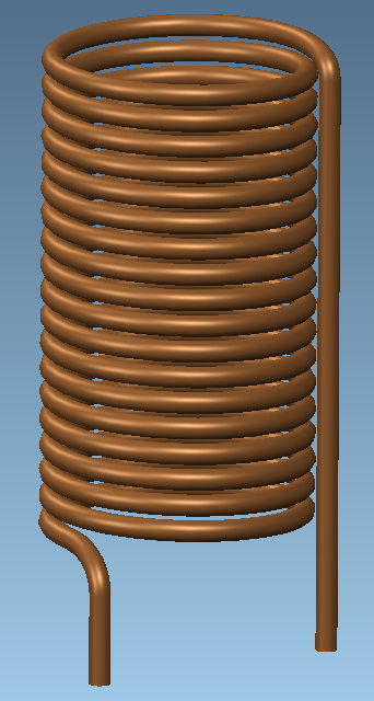

Hi there. Im fairly new to Comsol. I am trying to model an evaporation champer of an absorption chiller. I descided to model the geometry in Comsol, since i have a load of import problems from Creo 2.0(study version). My problem at the moment(im sure i will have more problems) is, that the cooling cirkut cosist of two spirals made of cobber. Now i have used the Helix to create the spirals, the problem is now, how to i control where the end stops, so that i can stop it 180 degrees off of the inlet, and hopefully make a sweep to return to the flange where the pipe/spiral/helix starts. Hope someone can help me.
The pictures show how i would like the model to look like. The picture is from creo.

Isnt that the "number" of turns of the Helix ? (in my 5.1 it seems so)
For your construction I would draw the central line and sweep along it. with workplaes at the end of the helix you can draw your 90° elbows easily.
Probably the "design" module would improve and ease the 3D handling as it incorporates far more of the third party Parasolid primitives (that is, I believe, the main cost behind the module ;)
Hi Isnt that the "number" of turns of the Helix ? (in my 5.1 it seems so) For your construction I would draw the central line and sweep along it. with workplaes at the end of the helix you can draw your 90° elbows easily. Probably the "design" module would improve and ease the 3D handling as it incorporates far more of the third party Parasolid primitives (that is, I believe, the main cost behind the module ;) -- Good luck Ivar

Yes it was exactly as u describe, it works perfectly and was actually very easy once i figured out how to control it :).
Thank you :)
