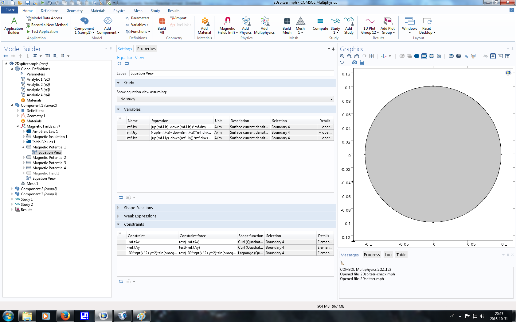

                                                Posted:
                                9 years ago
                                31 oct. 2016, 07:41 UTC−4
                                                    Hello
I can't access the subdomain settings window in Comsol 5.2a. Does anybody know if it is still available since if it is not i have to go back to the previous versions :(.
Arash
                            Hello
Arash
                                                                                                                                                    COMSOL Employee
                                                Posted:
                                9 years ago
                                31 oct. 2016, 08:34 UTC−4
                                                    Hello Arash,
If your reason for looking for the Subdomain Settings window is to see the equation system, then you can do that by activating "Equation View". To do so, click on the Show icon at the top of the Model Builder window (It's the one with a drawing of an eye on it) and from the drop-down menu check "Equation View". This will add nodes in the model tree in which you can see the equation system.
If you are looking for some other information, please post a clarification.
                            Hello Arash,

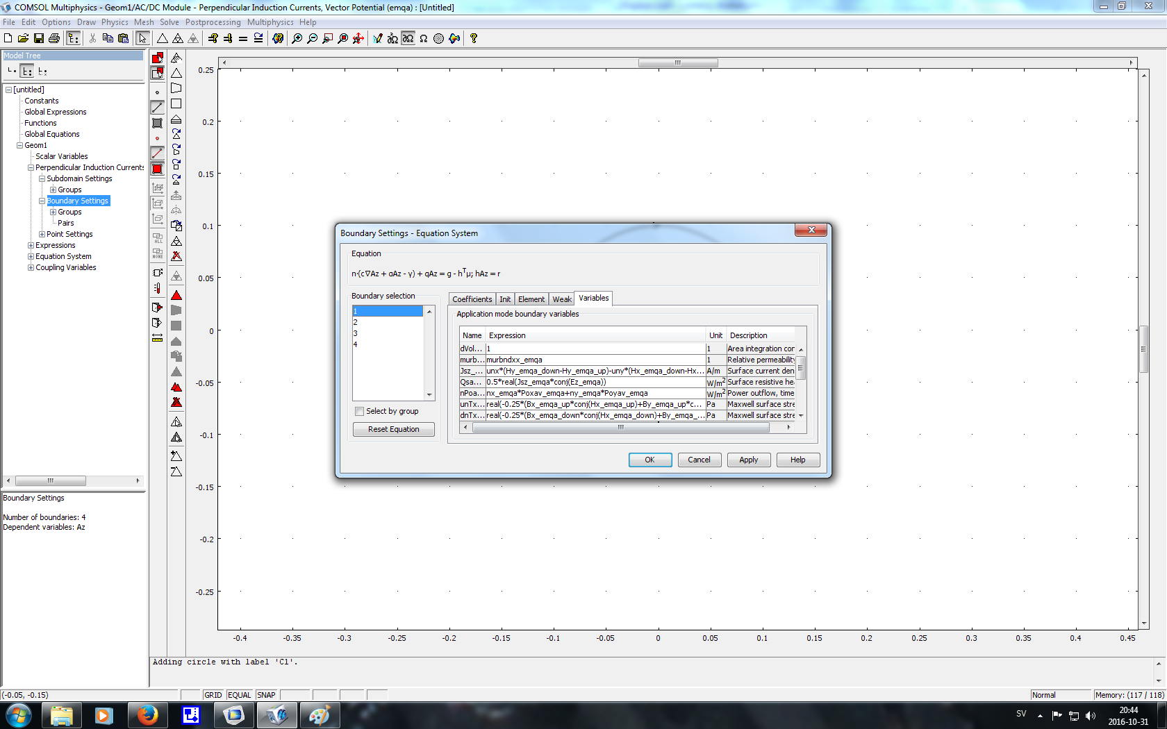

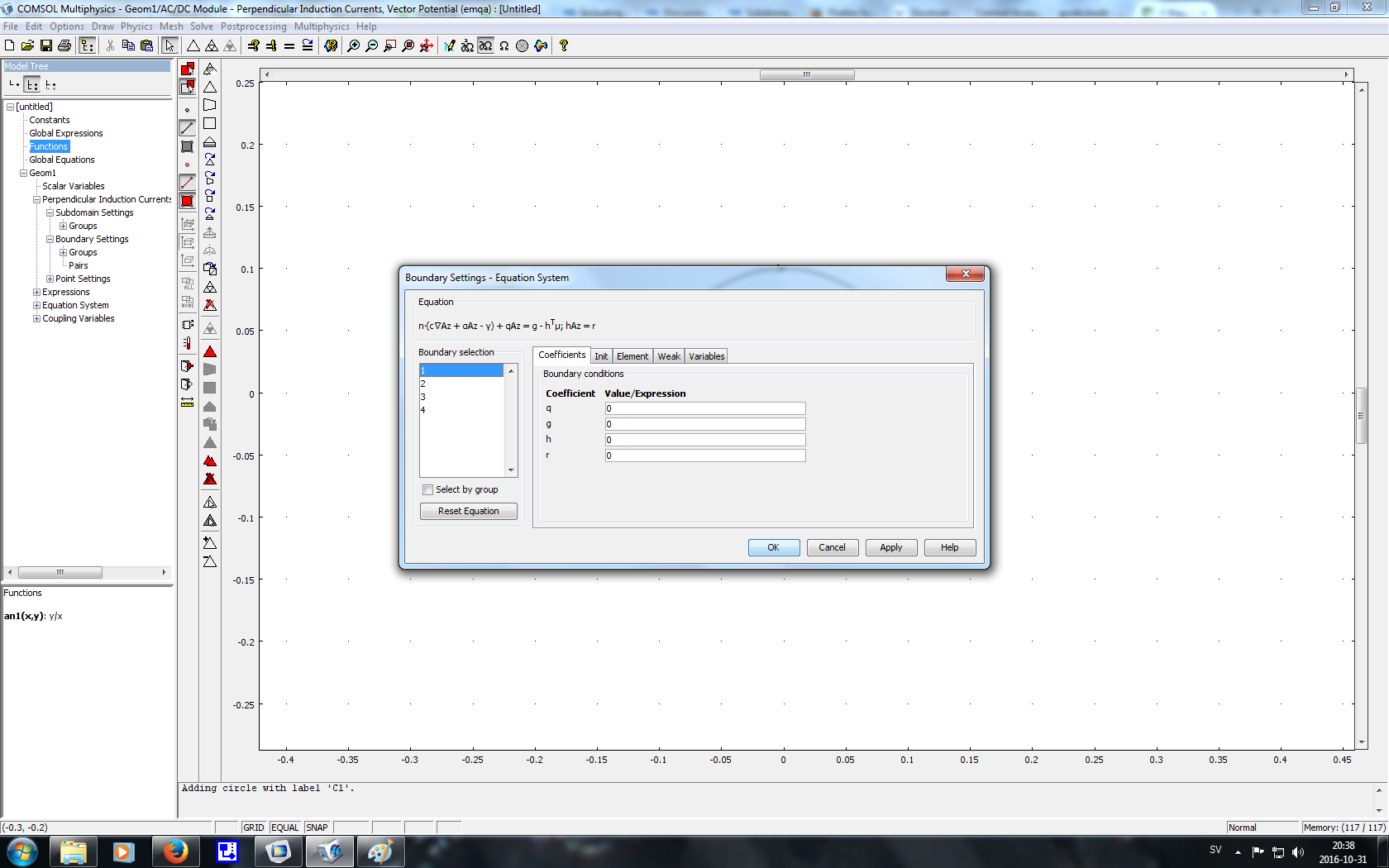

                                                Posted:
                                9 years ago
                                31 oct. 2016, 08:58 UTC−4
                                                    Hello Jeff
Thanks for the fast reply.
Well under equation view one sees the variables used in the model. I would like to see the differential equations with the coefficients and so on. These differential equations with their coefficients were available in subdomains and equation systems for example in Comsol 3.5 but i can't find it in 5.2a. The shortcut key Ctrl+F8 opens a blank pop-up window.
Arash
                            Hello Jeff
Arash
                                                                                                                                                    COMSOL Employee
                                                Posted:
                                9 years ago
                                31 oct. 2016, 13:00 UTC−4
                                                    It's not just the variables you can see there. You can also see (and edit, if needed) there the weak contributions to the equations, once you've assigned the nodes to a domain. You may need to scroll down in that Settings window for the Equation View node to see them.
If you're only interested in seeing the partial differential equations in Latex-like format, you can see them under the Equation Tab on the Settings window for the node in question.

                                                    In Comsol 3,5 i see the partial differential for the boundary (See attached- PDE-BC-Coeff-3,5). Under equation view for Comsol 5,2a on the boundary node there is (See attached- Variable-BC-5,2) which i would say corresponds to what you see in Comsol 3,5 at (See attached- Variable-BC-3,5).
Arash
Arash

                                                    In 5.2a, the Equation View window shows you the definition of variables but also any weak contributions as well as the constraints (i.e. the equation that's imposed on the boundary, expressed in the weak form) towards the bottom.
I hope this clarifies things. If doubts persist, please contact support.
