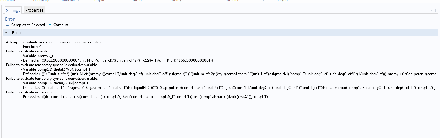

Error in sweep. The following feature has encountered a problem:

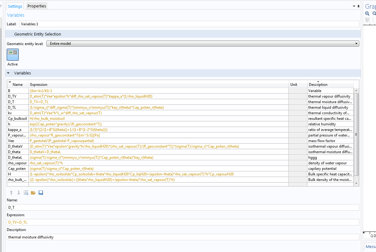

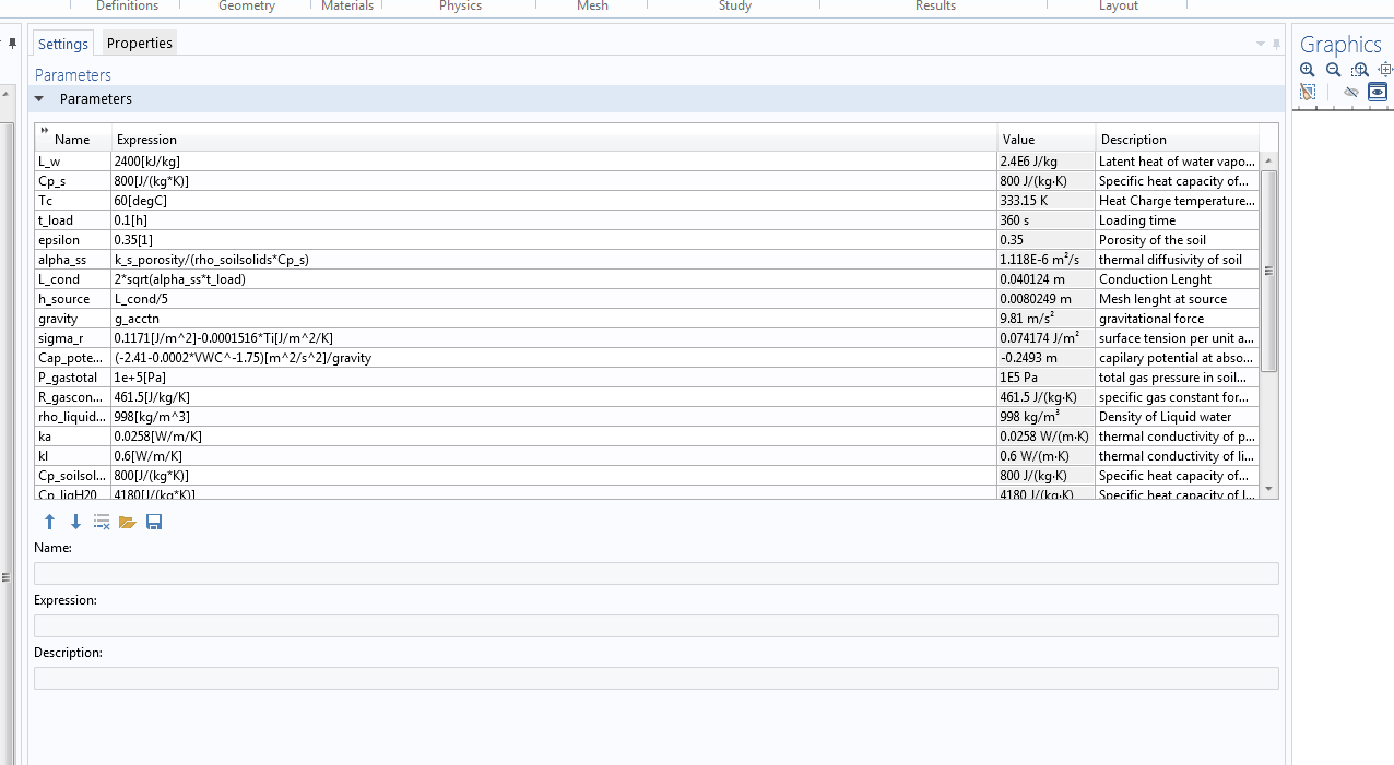

This is a problem i am encountering in trying to rum my simulation with COMSOL 5.1. I can't seem to get past here.
Attached herewith is my .mph comsol file, you just need to run it and see the error.
and also i attached a printed screen of my parameters table, variable table and the error window in case some one is not having comsol to run my file. Before i tested my model, all the units in my "parameter" and "variable" section were all consistent and superb. But all the "unit consistency" in the variable section are all lost after simulating and getting the error message.
