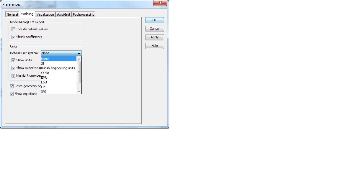

Is there an option not to have units in comsol 4.4 or 5.0. Comsol 3.5 has this option not to choose units.
I can't find it in comsol 5.0.. Attached is a screenshot of the option in comsol 3.5

Is there an option not to have units in comsol 4.4 or 5.0. Comsol 3.5 has this option not to choose units. I can't find it in comsol 5.0.. Attached is a screenshot of the option in comsol 3.5
Go to the model's root node and set Unit System to None.
