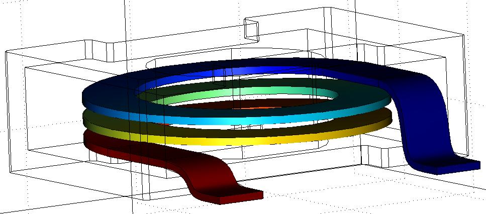

I would like to draw the winding of the power inductor model in AC/DC Module, COMSOL 3.5a. This example is not explained from the scratch, you must import the geometry. I need that kind of winding to try it on mi own designs. I can do an helix but this winding has a rectangular cross-section and its a bit difficult. Could anyone give me a hand on that? If you know how to do it with COMSOL 4.0 it can be a solution to my problem too, because I think you can export the geometry in the way that v.3.5a can read it. I don't have version 4.0a yet, still waiting for it.

I attach a screenshot of the winding that I want to model. It's like a circular helix, but with rectangular cross section. Actually, I would like to model it as an square-shaped helix instead of circular, but I think that this is easier to achieve as a starting point.

Hi Ivar, Thank you for your answer. I don't understand very well what you mean, but I think that it's not what I'm looking for. I attach a screenshot of the winding that I want to model. It's like a circular helix, but with rectangular cross section. Actually, I would like to model it as an square-shaped helix instead of circular, but I think that this is easier to achieve as a starting point. I really apreciate your help. Best regards, Lidia.

indeed I was thinking of a "square" where you have the spiral. Then you should try the extrude with torsion features in the CAD or the 2D to 3D mesh extrude, you may have better luck there
Hi indeed I was thinking of a "square" where you have the spiral. Then you should try the extrude with torsion features in the CAD or the 2D to 3D mesh extrude, you may have better luck there -- Good luck Ivar
