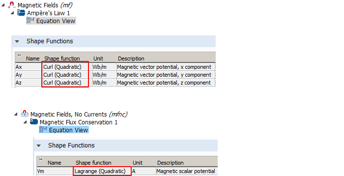

I have a problem with the magnetic flux gradient calculation in a quadrupole solved with the mf module.
If I simulate permanent magnet quadrupole I use the mfnc module and if I want to know the B gradient I define a cutline in the middle of the quadrupole equal to the bore diameter on the x (or y) axis
Then I select a line graph with that line as source and I plot d(mfnc.By,x) (or d(mfnc.Bx,y). The result is the field gradient of the quadrupole
If I do the same with a EM quad I have a gradient equal to zero even if the mf.By plot is not constant (it is correct as it has the tipical quadrupolare shape).
How I should calculate the gradient?
Francesco
Magnetic field interfaces use so-called curl or vector elements. Calculation of magnetic field gradient requires the second order spatial derivatives. This can be done by using Lagrangian elements, as demonstrated here:
www.comsol.com/blogs/plotting-spatial-derivatives-magnetic-field/
Sergei
Thank you for your answer, I'm going to study the link you sent me.
I have a question anyway. Why the d(By,x) work on mfnc module?
This is because mfnc interface uses Lagrangian elements for magnetic scalar potential and second order derivatives are available for Lagrangian elements.
You can see it under equation view, as shown in the attached image.
Sergei
Francesco,
Sergei
