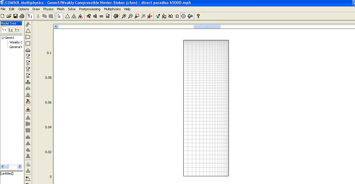

Edges of the wall have no-slip conditions, therefore the denser meshes are needed at the walls of the geometry. Because of that, I used mapped mesh parameters by defining the number of edge elements and element ratio (But I could only get denser meshes at 2 out of 4 boundaries-see attached files).

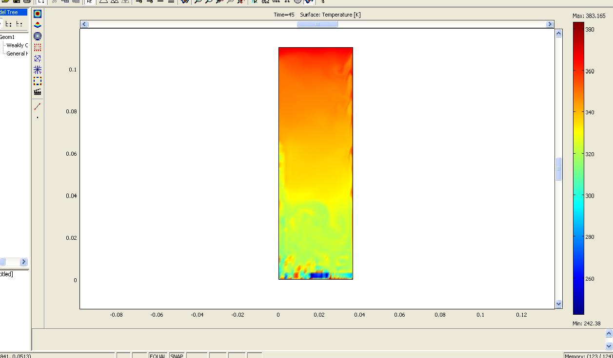

When I solve the problem with this type of mesh I obtain sharp temperature oscillations at a point which is the coldest point of the geometry. During comparison of simulation data with the data I obtained from an experiment very similar to this model, I get sharp deviations.
How can I get rectangular and denser meshes at each individual boundary?
How can I solve these temperature oscillations? Do you have any suggestion?
