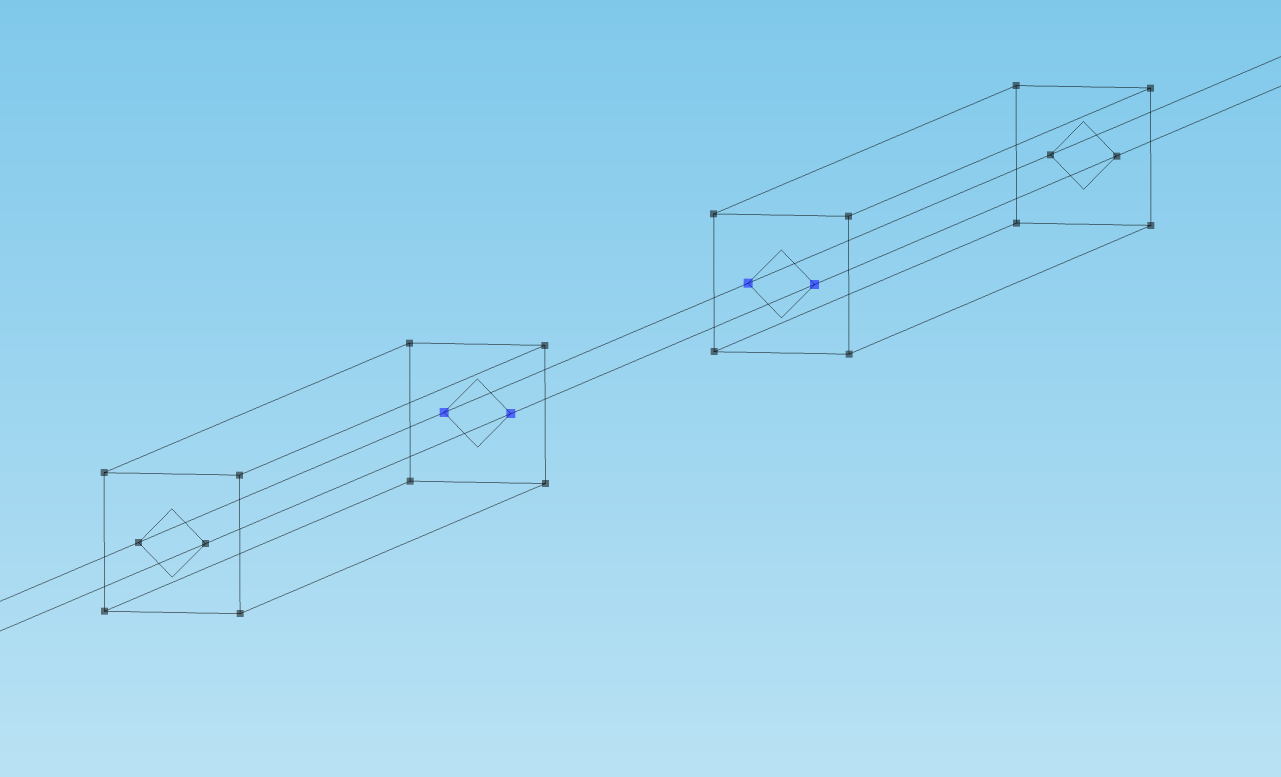

This should be an easy answer but for some reason I cannot find it in Comsol 4.0a. I have a fiber that i am heating up and I want to pick points on the fiber so that I can measure the displacement but only in the fiber direction (the z direction in this case). I know how to do a total displacement after the solution is solved, but not a z direction dependent displacement for a point. My problem is that I have this fiber sitting on a large metal tube and when it heats up, it expands in all directions. Thus the total displacement of the fiber is not realistic. If I can get the z direction displacement I can find out how much the fiber is stretching as a result of the heating up process. My overall goal is to calculate the strain (delta L) /(initial L) in units of microstrains ( 1 per million) by using these displacement numbers.

Hi Ivar, Thanks for your response. Yes the u, v, and w sounds like what I want. Where can you find these and how could I apply them for the 4 blue points in the picture I have attached? Also you mentioned the min, max, and average operators. Where can I find these to apply them in my model? Also would the first principle strain be the same as (delta L) /(initial L)? If not what should I be looking for in the postprocessing to get this type of output. I am unfamiliar with working with the heat transfer side of things since I mainly do research in the RF package so please forgive me.

Hi Ivar, Thanks for your response. Yes the u, v, and w sounds like what I want. Where can you find these and how could I apply them for the 4 blue points in the picture I have attached? Also you mentioned the min, max, and average operators. Where can I find these to apply them in my model? Also would the first principle strain be the same as (delta L) /(initial L)? If not what should I be looking for in the postprocessing to get this type of output. I am unfamiliar with working with the heat transfer side of things since I mainly do research in the RF package so please forgive me. Thanks again, -Neal
