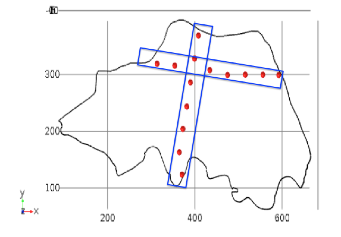

How is it possible to show volume plot for a special section of a 3D domain?
My 3D whole domain starts from x= [90-700(m)]
y=[50-500(m)]
z=[-10-2(m)]
But I want to show volume which is x=[360-400(m)]
y=[100-450(m)]
z=[0-2(m)]
I attached my domain and the parts that I want to plot in picture here (for better explanation).
How is it possible to plot it in comsol? Is it possible?
Thanks in advance for help
Sepideh

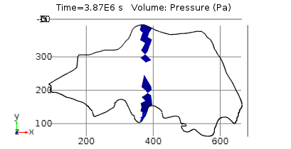

Posted: 1 decade ago 30 sept. 2015, 10:46 UTC−4
Hi Magnus,
Great, I solved my problem with your solution. But let me ask, I confronted with 2 questions:
1)When I tried to write logical expression like this: x > 360 && x < 400 && y > 100 && y < 450&& z > 0 && z < 2, then I was not able to show the volume plot, then I removed the z part, and it worked but
2)I applied this logical expression: x > 360 && x < 400 && y > 100 && y < 450
and I got plot (attached picture). I was expecting to have rectangle block but i is irregular block!
Is it related to my geometry? How is it possible to have simple rectangular block from this domain?
Hope to hear from you.
Sepideh

Magnus Ringh COMSOL Employee
Posted: 10 years ago 16 nov. 2015, 10:18 UTC−5
In COMSOL Multiphysics 5.2, there is a new Smooth option, which is now the default setting for the "Element nodes to fulfill expression" list in the Filter node's Settings window. Using that setting, you get much smother "filtered blocks", for example, even when the computational mesh is coarse.
Magnus Ringh, COMSOL
