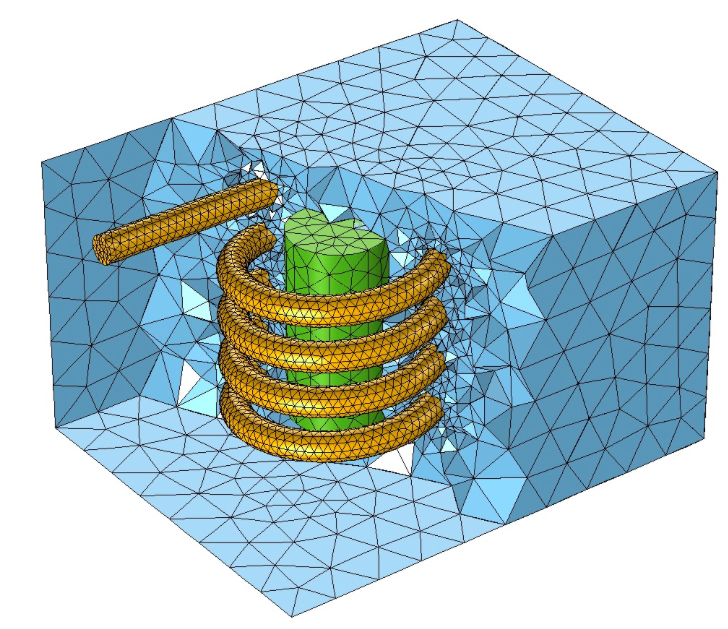

How do I make nice mesh visualizations like the one in the attachment? I.e.
1) How can I assign colors to different domains? I have colors added to materials, and Preferences -> Graphics and Plot Windows -> Show Material Color and Texture is checked
2) How do I filter only certain domains away -in this case air- and leave the coil and core intact?

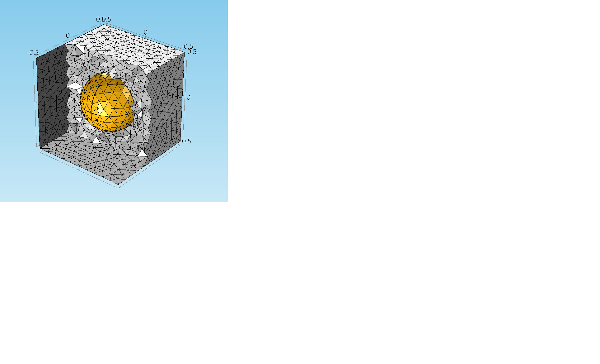

Plotting domains in a single color is simple: just make sure to specify a uniform (possibly custom) color of your choice instead of one of the predefined color themes in your plot settings (The default behavior for mesh plots is set so as to plot element Quality, rather than a uniform color). To do that on only one of several domains, add a Selection to the Data Set in question. You can use different data sets for different plots within a single plot group to achieve the most stunning results.
Plotting a fraction of a mesh can be done by using a Filter node.
See the attached files for an illustration of these ideas, and again refer to the above resources for more details and ideas for cool postprocessing in COMSOL.

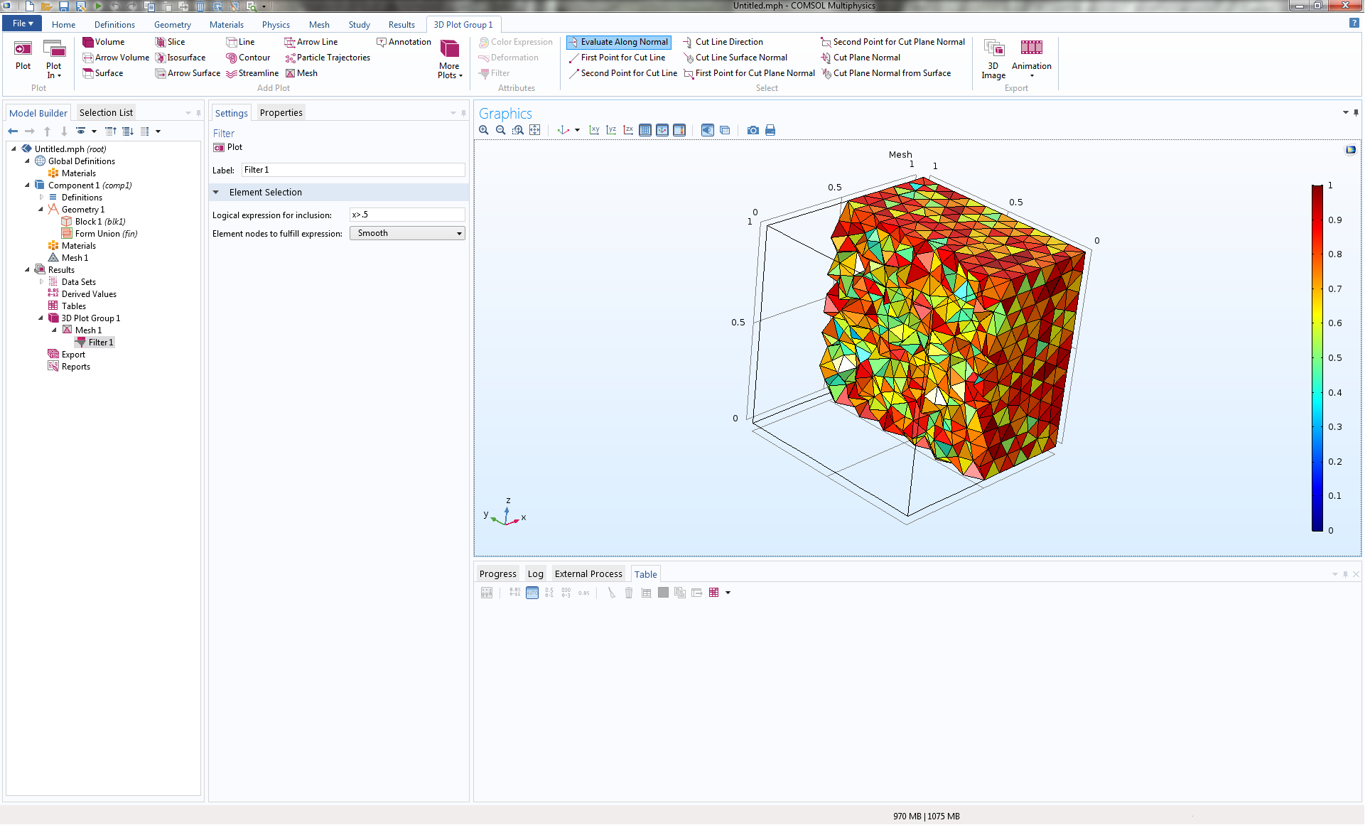

how do i view my mesh inside a domain (ie using a filter) without having to first generate a solution?

You do not need to have a solution to create a mesh plot, in fact you don't even need to have any physics defined. Just right-click on the Mesh 1 (or whatever the number might be) node in the Model Builder tree and select Plot to create a plot group containing a mesh plot in the Results branch. See attached screenshot.
